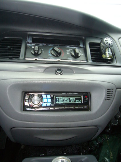

Hi All, New Here Too! This is What I Did.
Nice GM!
I definitely like that look, it looks a hell of a lot cleaner...
#1177757 - 04/26/07 10:14 PM Re: In-Dash DVD player problem [Re: TechnoWeenie]
Burmis Offline
Registered: 04/26/07
Posts: 80
Loc: North Eastern Illinois
A little time and plexi-glass;)
