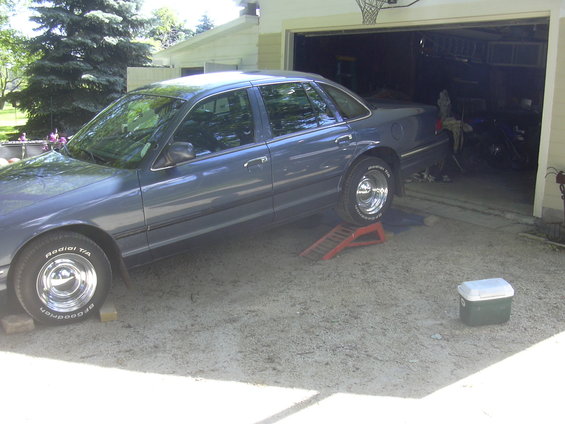

#1223306 - 07/01/07 12:33 AM Re: Rear end oil capacity? [Re: Ciffer]
Da Governator
Posts: 24369
96blu - did you fill the rear diff with it sloped on an angle (ie backed up on ramps) ?
Since the trac-lok diffs are larger and displace more fluid, LSD rear diffs will take a little less than the open diff rear ends.
-SL55 AMG (toy) -'15 GLK350 (d/d) -'95 Mark VIII (under renovations) -'02 Navigator ("beater")
RIP 2vmodular
#1223313 - 07/01/07 12:40 AM Re: Rear end oil capacity? [Re: dRock96Marquis]
96bluvic Offline
Registered: 10/27/06
Posts: 3052
Loc: southeastern WI
Yea, didnt think of that, and no i didnt put the tracloc in.
Not only was it on ramps, but also a slant in the driveway.
you think theres enough oil in there, just under 2 quarts? im sure its fine.
heres the angle
Back in with an 07 CVPI
#1223432 - 07/01/07 04:43 AM Re: Rear end oil capacity? [Re: 96bluvic]
Ciffer Offline
Registered: 05/16/06
Posts: 4360
Loc: Southeast MN
that is probably the difference then, i did my gear oil change with the wheels on the ground, and a full tank of gas, the bruises on the shoulders were fun the next day.
-Carl
