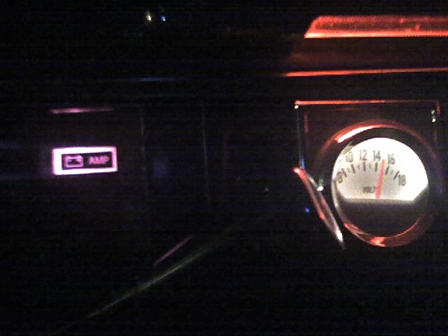

Ok here is my problem. I have ran test after test and got nothing. My charging system is working fine. I got no codes on my code reader, and I am at my wits end with this one.
My amp light flickers on and off when it is idling. The Volts gauge I got hocked up shows a good charge. (See pic. 1) When I rev up the engine the light goes out until I lay off the gas then it flickers back on. (See video) I have taken it to Midas, Advance Auto Parts, AutoZone, and they have no idea. Just short of taping over the light what should I do? Could it be the Alternator or a Regulator issue?

Ok here's the deal. I went to AutoZone and had them put the tester on it. It came up saying that the battery was low but the charging system was ok. So I went home and charged the battery up 100% It was at about 38% when I went to charge it. Now, the light is still flickering and after two days of letting it sit with nothing hooked to the battery I tested the battery again. It was lower but only at 98%. I put the battery back in the car. Started the car and the light was still flicking but the battery remained at 100% the entire time. Any ideas?
