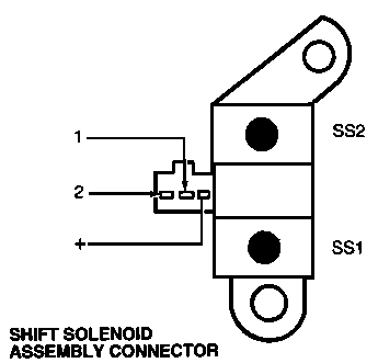

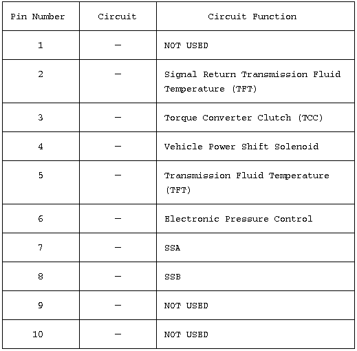

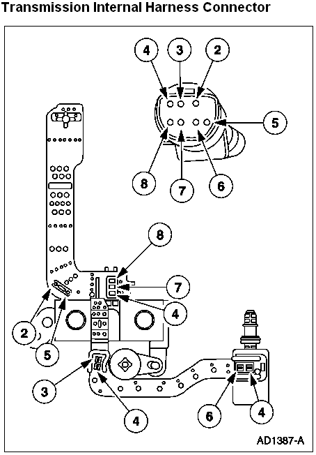

The shift solenoids are bolted to to the bottom of the transmission, inside the pan.
Shift A and B are part of an assembly, you can't replace them separately.
SSA and SSB should have 20-30 ohms. Externally on the harness you would ohm out pins 4 and 8 for SSB.
Internally, like this:
between + and 2 for SSB
00 Grand Marquis LS Premium - 97 Cougar 4.6 Sport - 89 Cougar LS - 63 Falcon 302 - 82 F-150 - 97 Mark VIII LSC - 2017 Escape SE
