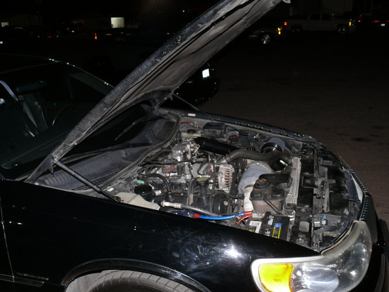

Here's a Turbo Town Car that Triangle Speed Shop did. Saw this at the track, but didn't get a chance to talk to the owner.
