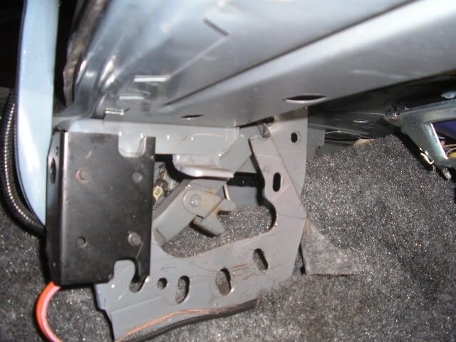

heres i pic of where the inertia switch is located, drivers side trunk hinge.

Excellent picture.
