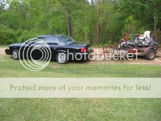

I installed a class III hitch in my 2001 p71. The only "modifying I had to do was drill two holes in the frame... there were no holes fir the 2 rear bolts. Other than that, not much to it. I use mine to haul a 16x8 single axle trailer loaded with lawn service equipment:
A class II would work fine for your trailer. It would probably work fine for mine too, but I got the hitch used for a good price and already had a couple of drawbars around, so I went with the class III

hitch is installed... went pretty smooth. Drilled 4 1/2" holes, used the bolt leader to get them through the frame... tightened the [censored] out of them. The tounge that came with the hitch looks like it'll work really good upright. I got the ball on there... everything is ready to rock!
