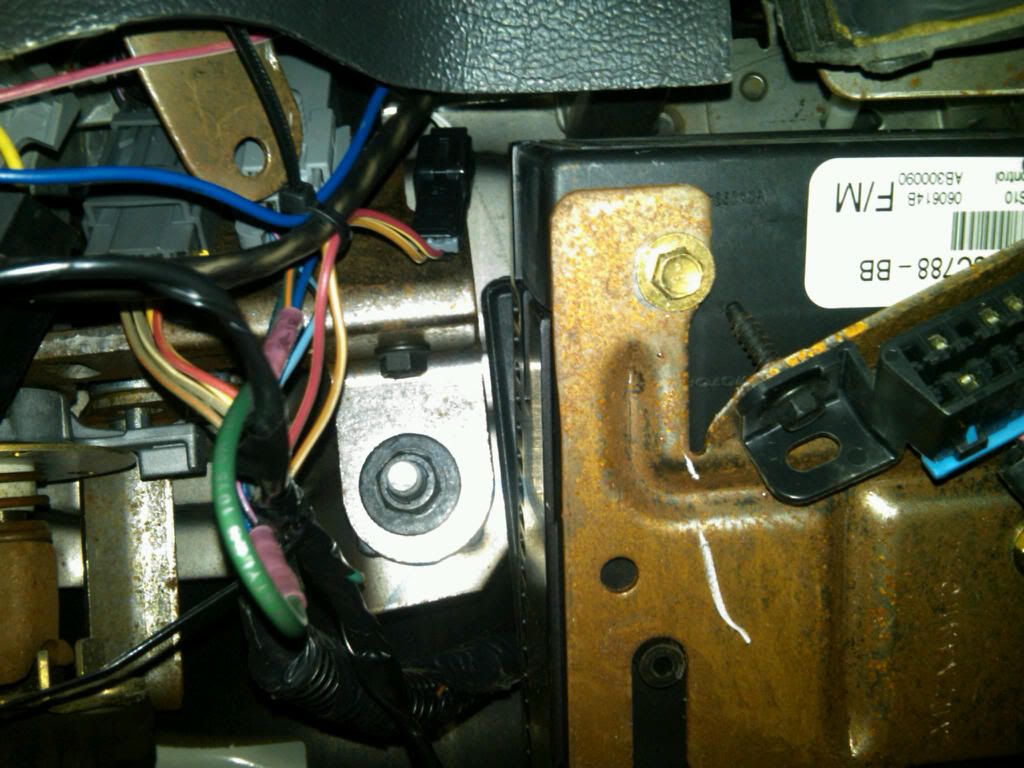

horn wire should be a blue wire under the dash, connector should be about 6" to the left of the OBDII connector. make sure they didn't chop it, or disconnect it or anything. if you hit that wire to ground with a jumper wire, horn should work, or at the very least, the relay should click (have a helper, gonna be hard to hear from the inside. if it clicks, the horns are dead, if not, there is something electrically at fault, fuses/relay, etc.

OBDII \/
It is actually a green/orange wire, NOT blue, I goofed that up, but in my pic you can see where they clearly spliced mine from removing the police equip.

#2131380 - 09/02/10 08:06 PM Re: Horn Not Working ! [Re: hellraiser319]
hellraiser319 Offline
Registered: 01/26/10
Loc: Moline, IL
Its the grey connector in the middle of the 3, on mine its that thick spliced in wire, if its all connected then clockspring probably is broken

#2132361 - 09/04/10 07:03 AM Re: Horn Not Working ! [Re: blazer]
blazer Offline
Registered: 06/28/09
Posts: 456
Loc: New Jersey
Per the above photos, all my sh!t is connected. Now how to figure out how to replace the clockspring. Appreciate the photos Hellraiser319,BIG help.
