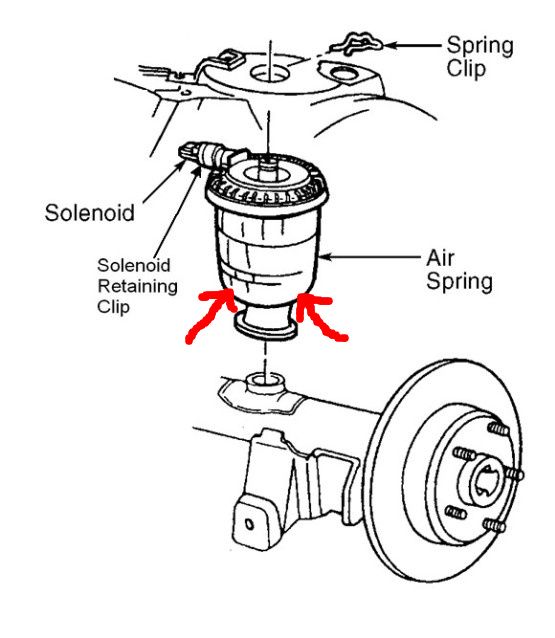

There is no way to test the system electronis without the Ford scan tool.
Does the rear drop all the way down when it's parked and does it happen quickly or does it have to be parked for awhile?
You visually check the condition of the air springs by checking the bottom of the rubber air spring right at where it sits on the hard plastic base, and worn bags will have vertical cracks. The bags will start to crack in normal use so some cracking is normal, but if there's alot then they would be suspect. Check the springs with the engine running and on the ground so you can see under there with a flashlight.
