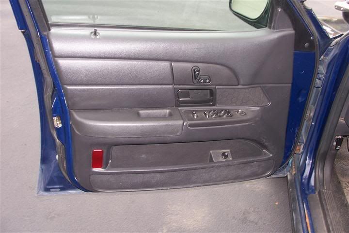

The new door panel was not as clean as my original, so I swapped out the switch section, based on an approach I saw in another thread. My original...
The new panel, front (more scratched than it appears in this pic)...
and back...
The swap took some drilling...
Some cutting...
And some epoxy...

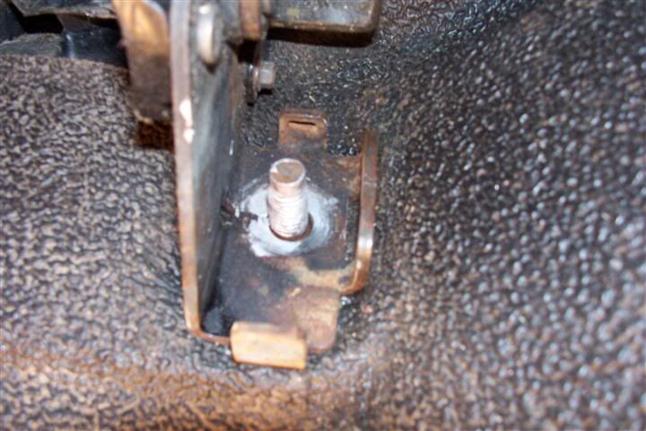

While the epoxy set I moved on to seat removal. My car already had one headless front seat bolt on the passenger side, thanks to the previous owner, so my plan was to soak the other three in PB Blaster over a couple of nights, and then remove them cleanly. I treated them from above and below...waited...began the removal process...
And ended up with this...
I was careful in my removal attempts, but the heads snapped clean off two of the three front bolts - one of them did come out cleanly. As for the rear bolts I had no problems, I was able to cleanly remove the flange nuts from both the large and small bolts. So my next step was to remove the front bolts from below. I confidently busted out my 10" vise grips, grabbed a tight hold, and wasted 20 minutes of my life in a futile attempt at getting those rusty stumps to move. Titanium drill bits are a wonderful thing...15 minutes later I had drilled out the three front bolts from above and was able to move on with the project. I used a 5/16" bit, which is just about the same size as the original Ford 8mm bolt. You just need to be careful and center the drill bit on the snapped bolt, it can be tricky to get started because the surface is likely not flat and the bit will travel if you are not careful. Starting with a smaller bit makes sense, to create a pilot hole of sorts.

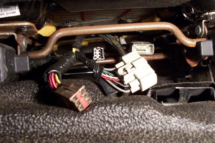

Connecting the power seat was a snap, everything was there and easy to plug in...

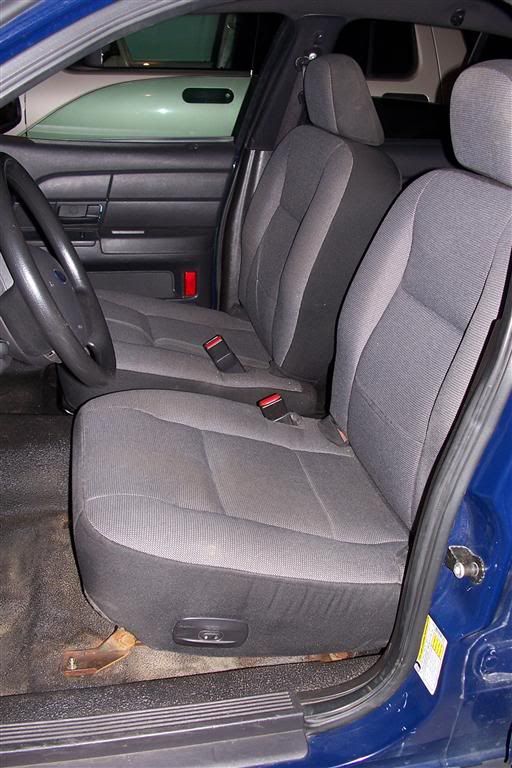

The new power seat works perfectly, and in addition to the power positioning, it provides much more support than the original beat up manual seat...
Driving the car is now a complete pleasure, as I finally have a comfortable, supportive and adjustable seat. It really makes a big difference.
