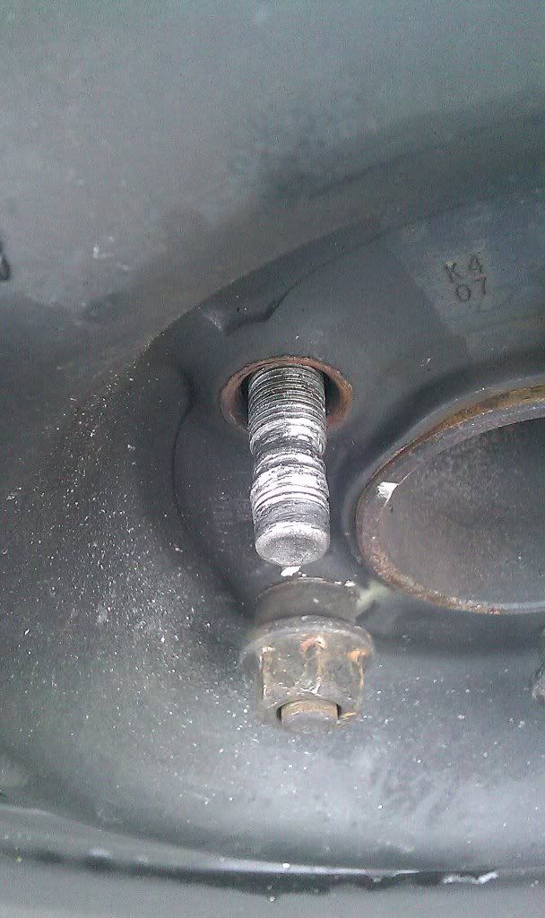

Long story short, the shop that did my inspection checked the brakes, and they must have F'ed up my lug studs when jamming the lug nut on with an impact wrench.
I had to change the tire yesterday and it was stripped.
I take it back there, and they all but cut the lugnut in half to get it off, then "did me a favor" by not charging me. They're not going to change the stud, and I don't know if I'm going to have time to take them to court, so ultimitly, I'm probably going to be the one holding the bag on this.
So, how does one go about changing a front, driver-side lug?
Here's a pic of the stud that got F'ed up.
Thanks in advance.
'07 P70 with 280K. Runs like a champ. laugh
Came with the "Taxi Chip"! grin
Want to throw throw money down the drain and make your car look like crap? Try painting your car yourself!

Mine is not that bad hairraise From what I have read.
1 remove wheel (duh) (have bad lug turned so it's at the bottom)
2 remove brake caliper (2 LARGE bolts near the hub)
This is where I stopped since my air ratchet was not strong enough to even try and turn them.
3 remove rotor
4 either use a special tool (Autozone) or hammer it out the back (there is a hole for it to exit)
5 install new one and use several washers and a lug nut to pull it into place.
I hope someone can chime in with more details for your and my benefit.
Especially on step 2
3 remove rotor
Jebus man! It's not that hard to get 'em off!
So are you saying I need to hammer the back, pusing it twords the outside of the car, or hammer the front of the lug, so it would come out twords the engine compartment?
It seems like an easy job from what you discribe. Hopefully other people will chime in to conferm.
Also, explain the washers a bit more in detail for me. I don't exactly get the picture you're trying to paint with it.
Does the rotor just slide out, or are there some kinda bolts/pins I godda remove first?

#2265156 - 03/24/11 12:31 PM Re: Replacing front lug stud [Re: P70_Owner]
Posts: 16569
yes, the rotor just slides off. Its my understanding that you knock the stud twords the engine bay since they are pressed in from the back of the flange. You use the washers kind of like spacers between the lug nut and the hub flange and use a old lug nut and impact gun to pull the new stud into place.
3 remove rotor
Pretty much the same procedure we used when replacing ones that broke on the race car.
If you can't get parts to come loose with an air gun, use a little penetrating oil (pb blaster, wd40) or heat them up with a torch, then try again, evenutally they'll break free and come off.
Hammer the stud from the outside and hammer towards the engine bay. When we replaced the ones on the race car, we didn't use washers, but highly recommended.
It'll take you more time to remove the brake caliper rotor, and wheel than it'll take you to replace the stud.
Very easy to do.
