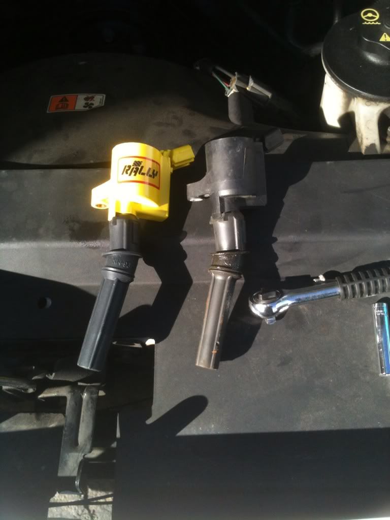

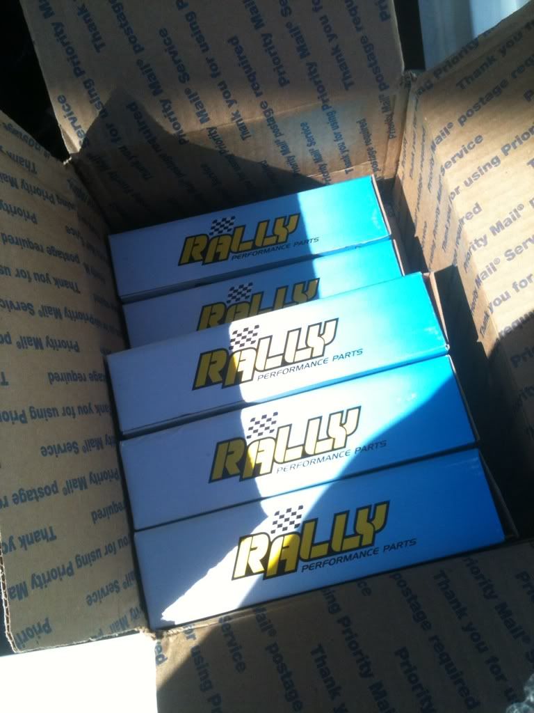

#2441319 - 01/19/12 12:22 AM Re: Coil Packs - when to change [Re: daiadvisor]
Posts: 9352
Pifft I've got lots of Kms on these and my car runs like a champ.
My OEM ones were crapping out so I replaced them. Roughly $120.00 for 10 Coils.
eBay for the win!! I took a chance yes, these could of been garbage, but they were not. That's not to say they are all great but don't dismiss an unknown brand to be trash just because it doesn't cost silly amounts of money. Don't fall into Price tag/name tag placebo effect people. Read reviews, research etc etc.
