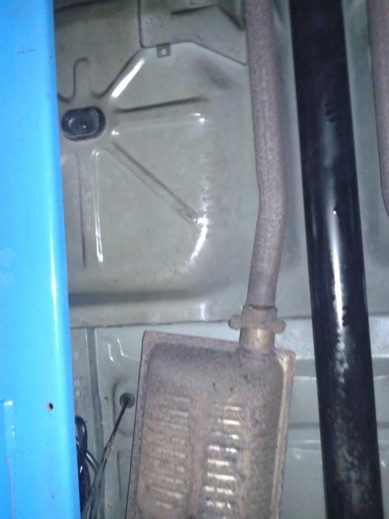

Also, underneath the car, I saw this thing situated underneath the area where the trunk is, anyone knows what this is?

Very nice clean looking car. I'm trying to remember what the black box under your trunk is for. I'm wanting to say something with the air suspension but I think it may be something else. Damn my memory
Its emissions related, I forget what its exactly called. IIRC it has to do with the EVAP system?
