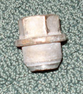

Howdy,
I have a 99 CVPI and I just got my police hubcap (not the pancake ones) and some Explorer lugnuts. I put the lugs on and and the cap doesn't go on. The cap isn't hard to get on, it just doesn't stay on at all. I can't hammer it down at all because it already touches the rim. Are the explorer lugnuts not the right kind for these hubcaps? I went to 12 (yes 12) Auto stores to find 20 of these things and now they don't work. What EXACT lugnuts do I need and where other than the stealership can I get them? Better yet, what are some part numbers for the EXACT ones I need?
Thanks in advance!

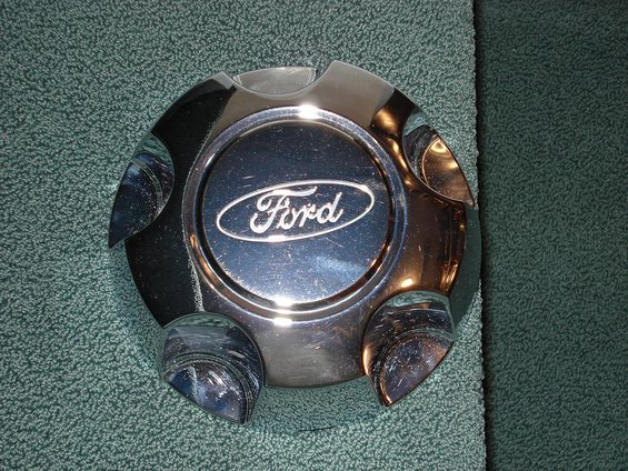

You have these caps?
Then you need these lugnuts
I bought 12. I used 3 per wheel and 2 of the ordinary ones and the caps where still on tight.
But I don't have the part #, I just asked for the 99 Police lugnuts for center caps from the dealer, They were about $1.50 a pop.

I found 'em. Had to go to four more auto stores but I got 'em all. The ones I bought before didn't have such an extreme collar around the nut.
