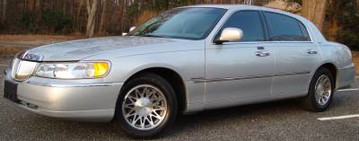

O.K so you guys totally lost me, Accufab combo TB and Planum, i install it easy swap, DO I NEED A TUNE TO GET THE MOST POWER??? and a tune as in xcal2? what should i tell them to do on it?

A throttle body and/or plenum upgrade does not require tuning.
However, with many engine upgrades that doesn't mean that tuning cannot be enhanced to better compliment the new bolt-on. Again, it's not required, though. I don't think you'd notice a difference after being retuned for a new plenum, which is why Lonnie said you don't need to. Besides that - although the plenum can now flow more, the MAF will still read exactly how much air is coming through to the engine so the PCM will know there is more airflow coming in......
