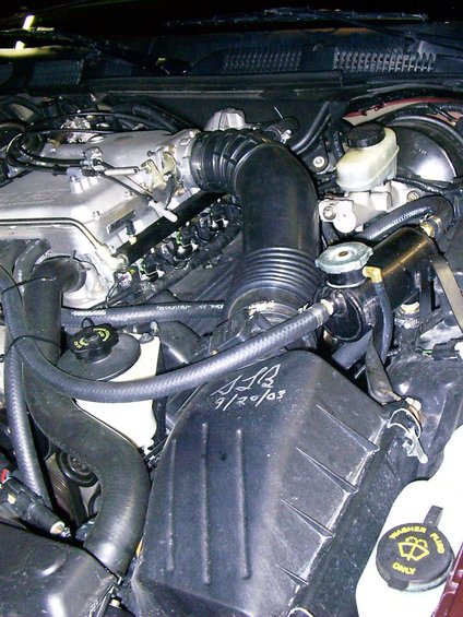

#1344937 - 12/13/07 08:34 AM Re: The "MZT" and some popular bolt-ons [Re: dRock96Marquis]
JohnE Offline
Registered: 04/02/01
Posts: 2258
Loc: Houston
Great write-up. Excellent looking engine bay!
Here's the same setup on mine:
John
