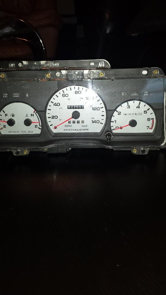

So, I made the ballsy move of starting this at 5pm on a worknight. With that in mind, things turned out reasonably well.
The good:
-VSS input working, speedo works properly up to 60ish, where the needle appears to be binding
-Swapped odometer, appears to be working
-Didn't mess up the charging light, getting a constant 12.8-13v in cabin.
- Coolant and gas gauge also appear to be working.
- Turn Signals work
The meh:
- Tach not hooked up yet, no biggie
- I should probably get a new alternator, given that it's only putting out 13.7v-ish
The bad:
- The CEL and OD-off light are on, but very dim. OD is on and the PCM isn't throwing any codes, so I'm not sure why exactly they're on. As a reference, the CEL lights up fully with key on engine off and looks normal. When running, it's on but barely. Anyone have an idea here?
- None of the backlighting works. I've got pin 3 on the white connector spliced to pin 16. With the parking lamps or headlamps on I get +12V between pins 15&16, and +12v between pins 3&15 (15 is ground). I checked the pins again, they seem fine. Could they not be making contact? Or might it be something else?
Edited by Captain_Slow (04/07/13 11:53 PM)

#2693331 - 04/08/13 02:00 AM Re: The Marauder Cluster Swap... [Re: Ezbok58a]
Posts: 9428
If it looks like the OD light is on but really dim
it might be caused by overly bright bulbs behind or LEDs
See here on my 2003 when I replaced my stock gauge bulbs
with LEDs there were so bright it made the other spots look like
they were lot up. The air bag light is slightly lit because the LEDs were
so bright
Nevermind I re read your post and it says your back lights are not
working sorry I missed that.
Edited by KayTar (04/08/13 02:01 AM)

Update... The lighting issues boiled down to LED bulbs put in backwards (the CEL and OD-off, which partially lit because of how they're wired I think, and ALL of the illumination bulbs, which didn't light because the polarity was backwards).
Still need to get the tach hooked up and play with the speedo a bit though
