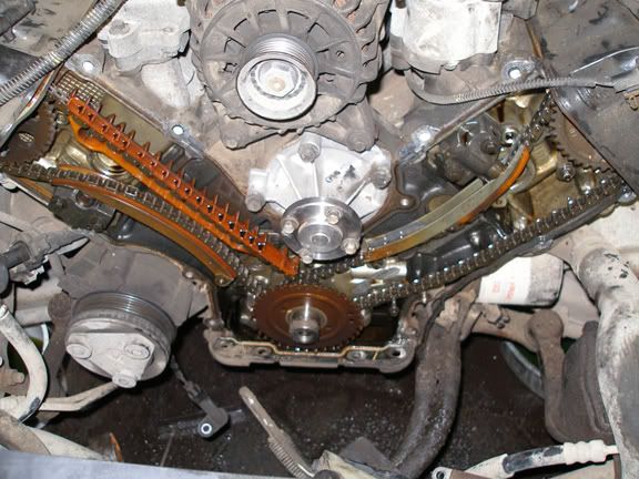

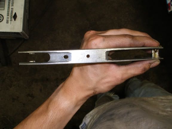

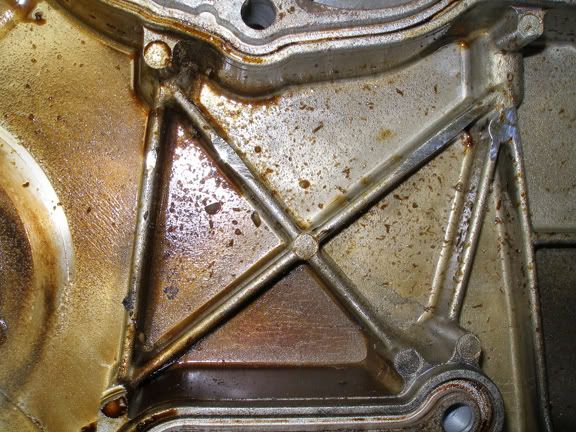

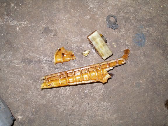

First off, I'd like to thank luv-my-2002-p71 and dRock96Marquis for putting together such a good writeup on timing chain tensioner replacement in the BOK. Unfortunately, I discovered the information just a bit too late for my dad, whose '01 has been making the dreaded "grinding sewing machine" noise for several weeks. He was driving home from work on Friday and suddenly lost oil pressure (this not 24 hours after I had figured out what the problem was and what could happen if it wasn't taken care of). We got it pulled apart this weekend, and the carnage was pretty great.

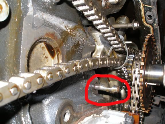

Here are my questions: In the first picture, the circled part is the pin that mounts the top tensioner arm on the driver's side. As you can see, the chain wore it about halfway through. We'd definitely like to replace that pin, but is it pressed in? If so, is there any good way to replace it or do we have to get creative?

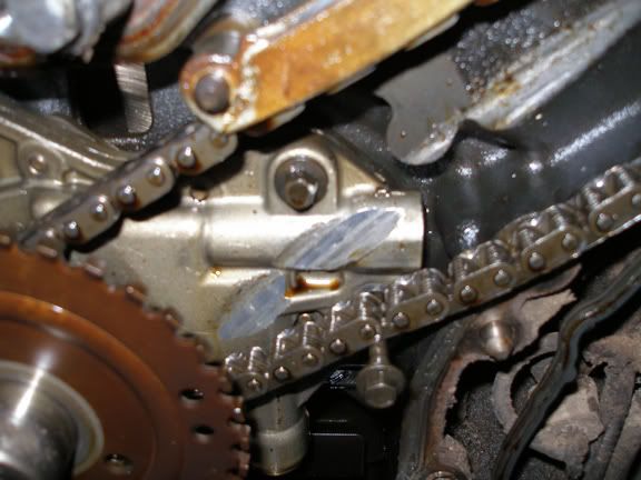

Next, this picture shows where the chain has worn away a significant portion of the oil pump case. If you look closely, it almost looks as if it's worn through at one point. Is the upper, cylindrically-shaped portion the pressure relief valve? That's the spot where we think it may be worn through, and obviously, if it is, it will let all the oil pressure out. That, of course, means replacing the oil pump, which necessitates removal of the chains. Where do I buy the specialty tools for timing the engine after replacement of the chains, and will we have to take out a second mortgage on the house to pay for them?
And now, some more pictures of the carnage for your sadistic pleasure:
Thanks in advance, everyone.

You can normally find the cam tools on ebay.do a search for rotunda toolkit or tkit, that should bring them up. their made by OTC so you can buy them brand new from vendors. i would replace the oil pump. better safe than sorry, and if it is messed up, putting it together and having to pull apart again is a learning experiance. the pin, have no idea...have yet to open mine up yet.

You may want to consider installing a used engine in the car. If you lost pressure, you run the risk of damaging the rod/main bearings. If you decide to repair your engine, the oil pan will need to be dropped to clean the pickup screen.

+1^ with that kind of metal flying around and running the car without oil pressure, even for a short while, will cause damage to the engine. You might get it back together and have it run fine for a few thousand miles but then it will start having problems.

Oh boy that is some of the worst carnage I have seen on the whole timing chain issue...I agree with everyone above you must clean the oil pan from all the debris that is pleathered with.. Good luck with everything, check on a used engine as well.

In order to replace the mains, the engine will need to be pulled. By the time you purchase chains, tensioners, guides, arms, oil pump, rod/main bearings, you will be better off spending that money on a used engine. To much risk of the engine taking a poop after having all that metal running through it.

Starter is easy once you learn the tricks, but took me a long time the first time too. You can pull the pan from underneath but you have to lift the engine up off the mounts to do it for clearance around the cross member IIRC. So there should be room. The point really is that other damage could have been done by now and not just to the bearings. The oil pump could be damaged from the metal going through it, the cams could be damaged from lack of oil and how do you know that the chain hasn't skipped a few teeth during this. If the timing chain skipped you likely have bent or broken valves. No way to tell without a compression test and you need the starter in place and good timing chain guides for that as well. So yes you could fix it a probably get it to run right for a while, assuming no bent/broken valves, but it would likely only be a matter of time until the engine had more trouble.

The ENTIRE BLOCK would need to be flushed out if you really want to keep the current motor.
If you just replace the bearings, there is TONS of debris inside all the oil passages in the crank heads block etc...
The debris will end up damaging the bearings, and worse the cam rides directly on the heads so the "bearing surface" will get scored.
REPLACE THE MOTOR WITH A $600 low mile used unit!!!!!!111!!1

Yeah, if yours has 128,000 on it I'd get a donor engine out of a yard, do the timing chain on that, and drop it in. Flushing all the metal filings out of the block isn't going to be any easier than swapping the whole lump anyway.
