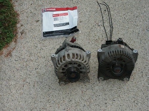

The "new" 6g alternator is on the left, the old broken 4g alternator is on the right
here's a top view of the alternators. notice the different regulator connector and the different orientation of the output stud

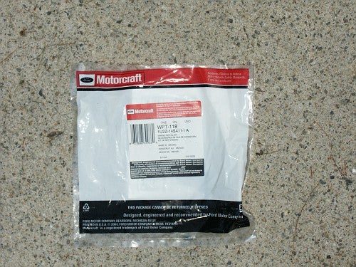

here's the regulator wiring pigtail to splice onto the civilian vehicles harness so that a police unit can be installed
here's the factory civilian charging harness. for my purposes, i'll cut off the civvy regulator plug and splice on the police one. the output stud wire has a little different contour to it near the terminal, but can be bent into shape with my bare hands

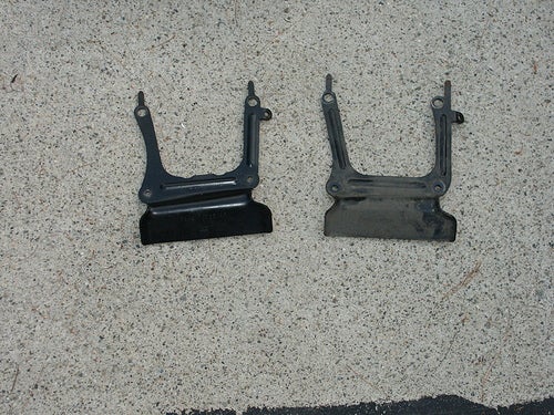

here's the support brackets for the alternator. the one on the left is the police 6g unit, the one on the right is the civilian 4g

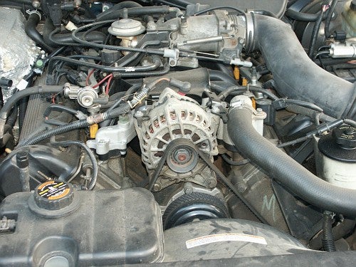

here's the police alternator mounted on the civvy engine block

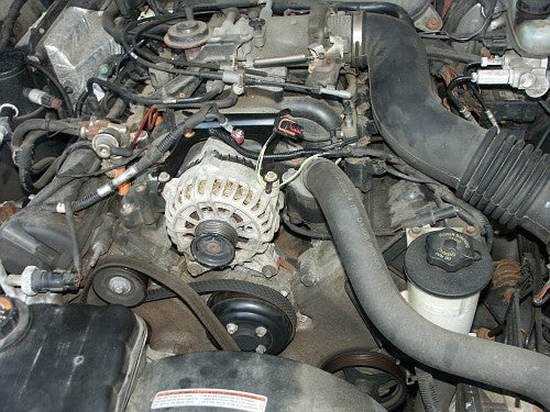

and here's a police interceptor with a factory installed 6g alternator for reference
