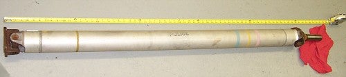

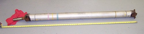

Below are pictures of a driveshaft removed from a 1997 ford crown victoria police interceptor
This driveshaft is aluminum which minimizes corrosion in relation to the steel driveshaft used in civilian crownvics.
Here's the slip yoke. If you're purchasing a salvage yard driveshaft, watch for corrosion on this part.
The lubed-for-life u-joints in these driveshafts seem to have a good long service life, often going over 150k miles without any problems.

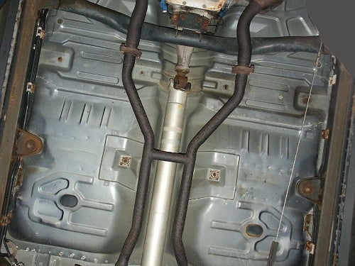

The rear tailshaft of the transmission, transmission crossmember, and the front passenger's floorpan
The floorpan shown here is where the front seat bolts attach and where the front passenger's feet would normally rest.

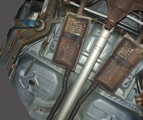

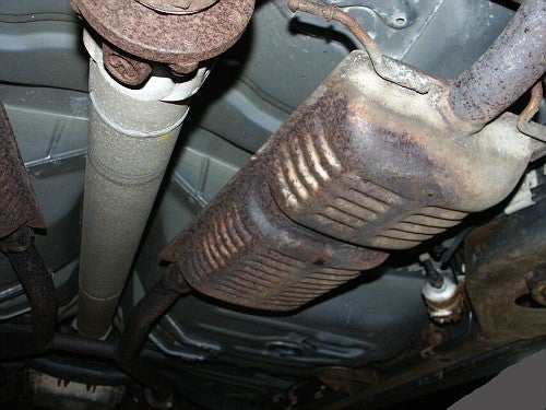

Here's the differential flange, the two exhaust system mufflers and the part of the floorpan under the rear passengers.
Here you can see the trunk floorpan, differential, evaporative
emissions box, and various other components
To remove the differential flange bolts a 12mm 12-point socket is used

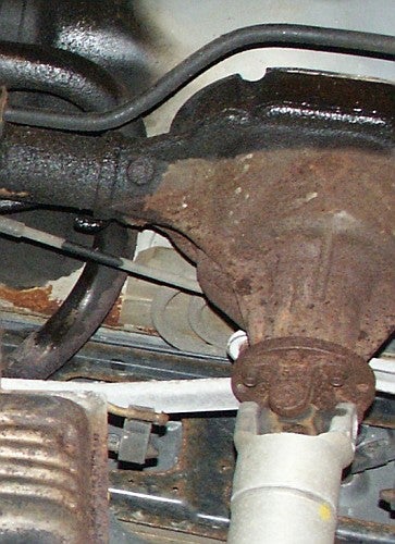

The car from the rear behind the differential. If you look closely, you can see part of the driveshaft
The differential mounting flange from the back. And yes, this car needs new rubber muffler hanger insulators installed.
Here's the front passenger's seat crash reinforcement bracket where the passenger's seatbelt latch attaches.Also note the words "POLICE" written on the driveshaft.
