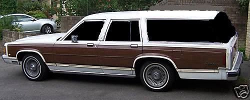

I will photoshop the finished project to give an idea of what it will look like.
Just for a mess about, here it is with black windows!
Andy.

Right, which one do you prefer?
Andy.
www.lowcamaro.com

wow, looks like a heck of a project!
good luck with it all! looks like you know your way around american cars.
And i like the first one- just the windows black.

As for the window tint options, of the 3 choices you gave I'd go with the first one also. But depending on the body color you choose, I might prefer a combination of the 1st and 3rd options like this:

I like the second, looks modern.
