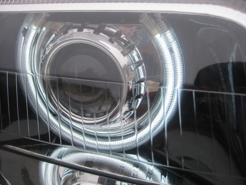

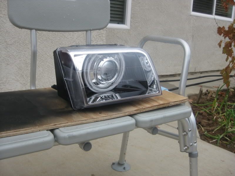

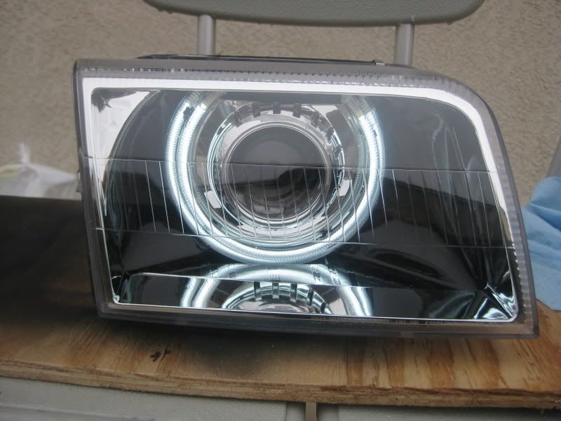

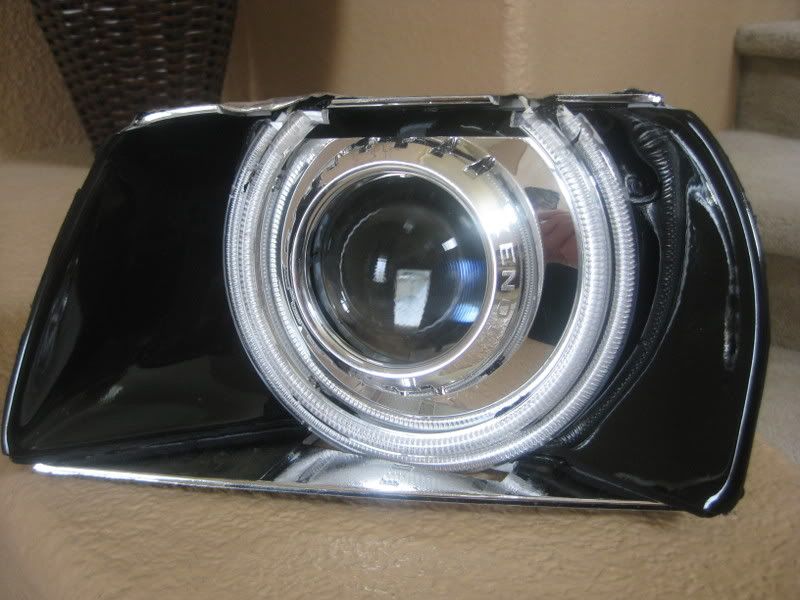

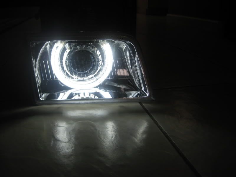

Ok guys here are some detailed pics of my custom headlights:

Details for this headlight: I bought a pair of aftermarket OEM 07 Grand Marquis headlights, infiniti FX 35/45 bixenon motorized projectors, OEM BMW M3 shrouds, and 4 BMW M3 CCFL halo rings...all these parts can be found here: http://store.theretrofitsource.com/index.php?cPath=25&osCsid=b01e0bcf8bba915848517e75a9ed0fd7
Further details on how to exactly get it done is a hassle to type, so check out these 4 parts of the video here: http://www.youtube.com/watch?v=imIiglkq7HA
***** BTW im selling the 4 halos because im buying a more blueish white halo rings, cuz the ones i have on are kind of warm white, PM me if ur interested \:\)
