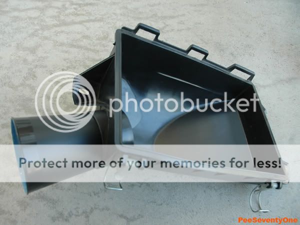

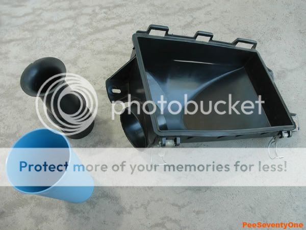

I started the one for for the ford trucks, exactly the same idea take a look
http://www.f150online.com/forums/exhaust-intake-systems/297846-gotts-intake-pics.html
1995 Lincoln Town Car - 5.4 swap, no cats, true dual magnaflow, trac loc, 4 link, ported intake, SCT tuning
2000 F150 5.4 - Long Tube headers, Gotts intake, magnaflow exhaust, UDP's, efans, ported intake, 75mm TB, SCT tuning, 33" Firestone M/T's

imo the PVC looks alot closer to stock.. much cleaner..
but the same thing is accomplished, so cheers to you !

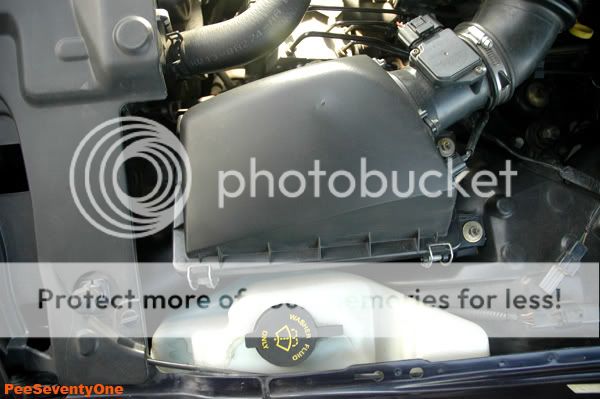

Today, I removed the snorkel from my airbox. The 99 Store sells three plastic cups for... you guessed it. Pics work better than words:
Painted the cup flat black with Dupli-Color Vinyl & Plastic paint. Conclusion: spent a very short amount of time, 33 (plus tax) on a cup, and the cabin sounds better when hitting passing gear. Also, the cup extends further past the body frame than the snorkel. In theory, there should be more cooler air entering the box in addition to the larger opening.
Whether it works or not, it was a fun/quick project and it sounds better.
