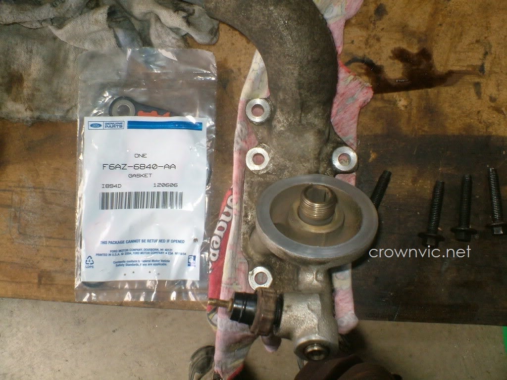

Before starting, you will need to order a replacement oil filter adapter gasket;
F6AZ-6840-BA CVPI/Towing (w/ Oil cooler, blue colored gaskets)
F6AZ-6840-AA All other (w/o Oil Cooler, orange colored gaskets)
(Note, despite the No cooler designation for the orange color -AA part, it has been factory installed on several CVPI model years)

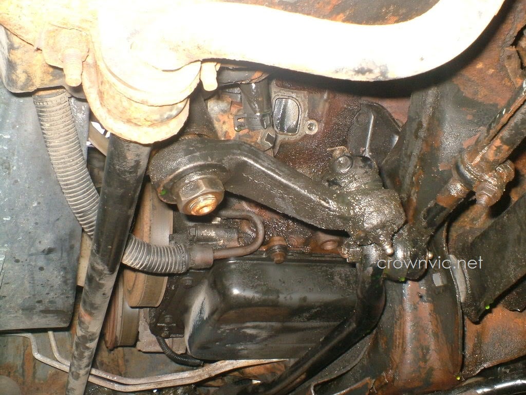

The pictured vehicle uses the -2002 style steering system, 2003+ models will not have these components in this arrangement however the general procedure is the same.

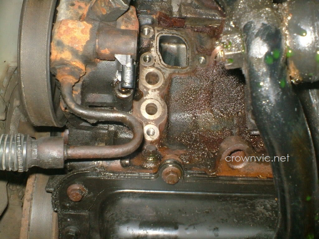

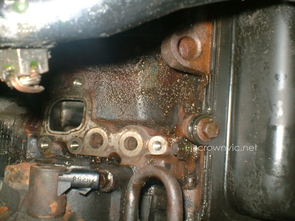

So, since I could not find any pictures of this adapter or it's associated parts, I thought I would post some. It's an easy job, all standard rules apply.
  1. Cleanliness in this area is a must as particulate matter can enter the oil system. Clean everything before removing the parts! A pressure washer and degreaser works well
  2. Drain Engine coolant into suitable container by turning radiator drain petcock counter-clockwise
  3. Disconnect lower radiator hose from oil filter adapter (inspect hose condition, replace if needed)
  4. Disconnect engine oil cooler hoses (if equipped, CVPI/TOW)(inspect condition, replace if needed Body of Knowledge- Oil cooler hose replacement - by Nomad8324)
  5. Disconnect oil pressure sender wire
  6. Remove engine oil filter

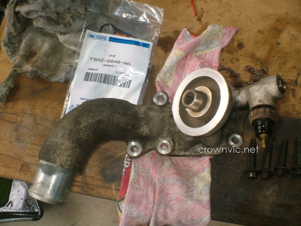

  7. Remove 4 bolts securing oil filter adapter to block, and remove oil filter adapter

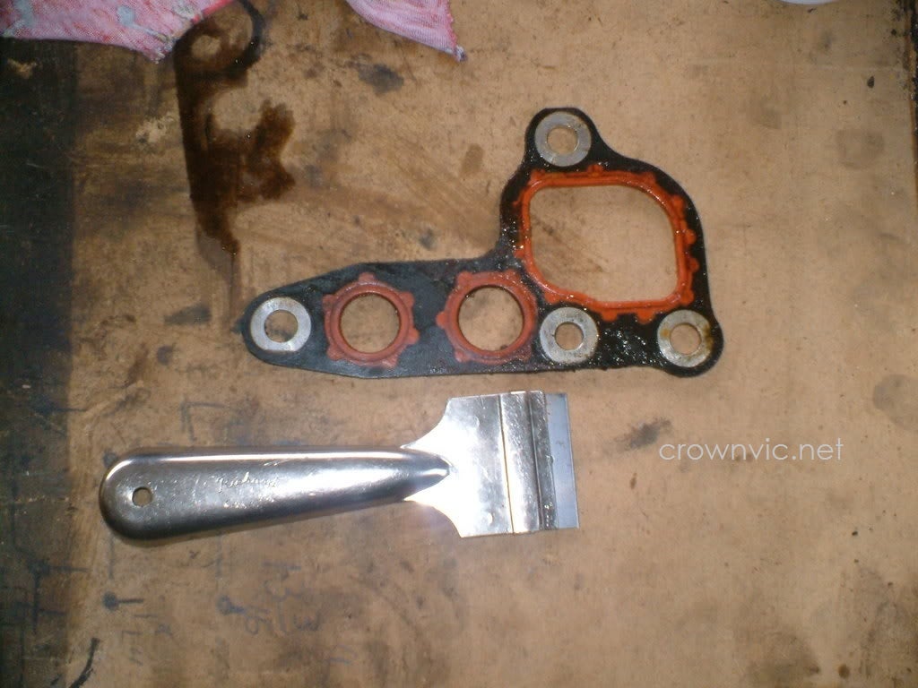

  8. Using small rags or similar, plug the block openings to keep out debris and thoroughly clean the block and adapter mating surfaces of contaminants and gasket material. Note, the oil filter adapter is cast from aluminum - a gasket scraper should be avoided as the surface can easily be gouged. Flush the passages on the oil filter filter adapter with compressed air and carb or brake cleaner to ensure there is no debris stuck inside.
  9. Reposition oil filter adapter, sliding bolts through adapter casting and align new gasket.
  10. Torque oil filter adapter bolts to 18lb-ft, starting at the rear ('right' when looking straight at adapter) most bolt first, then working from top to bottom for remaining three.
