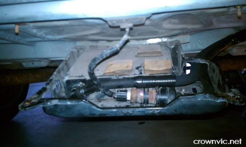

On 1998+ models, the EVAP canister, and canister vent solenoid and line can be found directly under the trunk (large black box) with solenoid vent outlet line leading into passenger frame rail opening

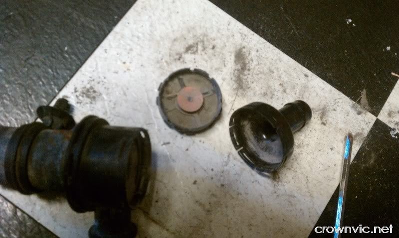

Well I've been getting a check engine light with a code P0442. Small leak evap. I, like everyone replaced the gas cap and reset it. Didn't come on for a while, then it did again. Apparently the pcm tells the evap system to do a test depending on how much fuel in the tank, temperature, and other parameters. If it senses a leak, it puts a pending code, does the test again. Then a cel if nothing changes.

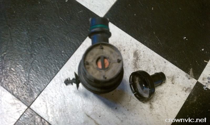

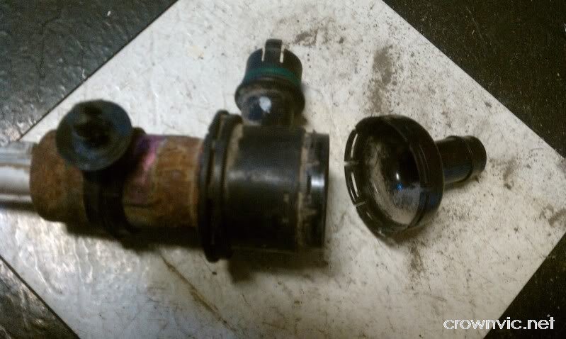

Took the vapor canister off, the solenoid, the vent solenoid, and lines. Checked them all and cleaned everything with contact cleaner and compressed air.

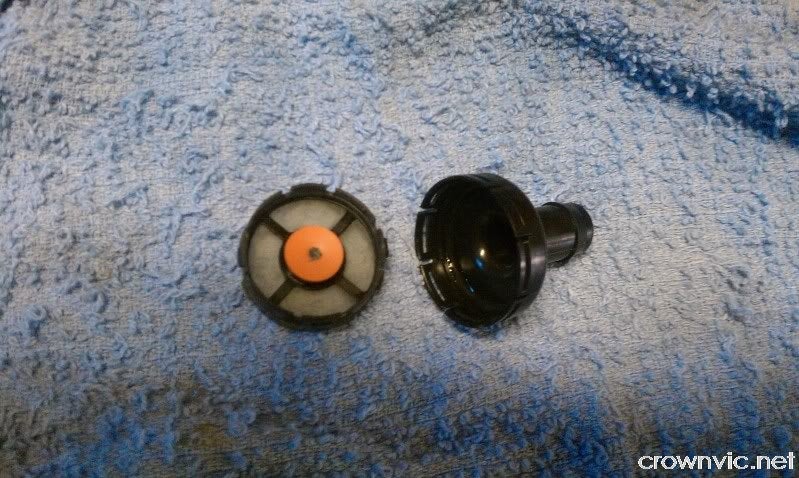

The canister solenoid had dirt and debris when I pulled it out. From reading on this subject, most of you just replace it. Upon further inspection of it I noticed the plastic side where the hose slips in is serviceable. With a small flathead screwdriver I took it apart carefully. Was I glad I did. There is a screen with a rubber membrane in there and it was filthy. Debris was keeping the membrane opened and I'm sure this was causing the error code because when the solenoid turned off air was still getting in there because the membrane was stuck in open because of the debris.
Cleaned it all up, and tested it.. wanted to add incase anyone ever runs into this problem..

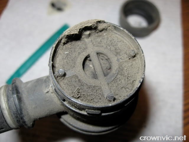

An example of a very dirty vent solenoid causing a P0442 code courtesy Tim835
