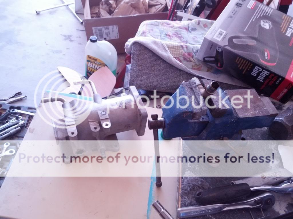

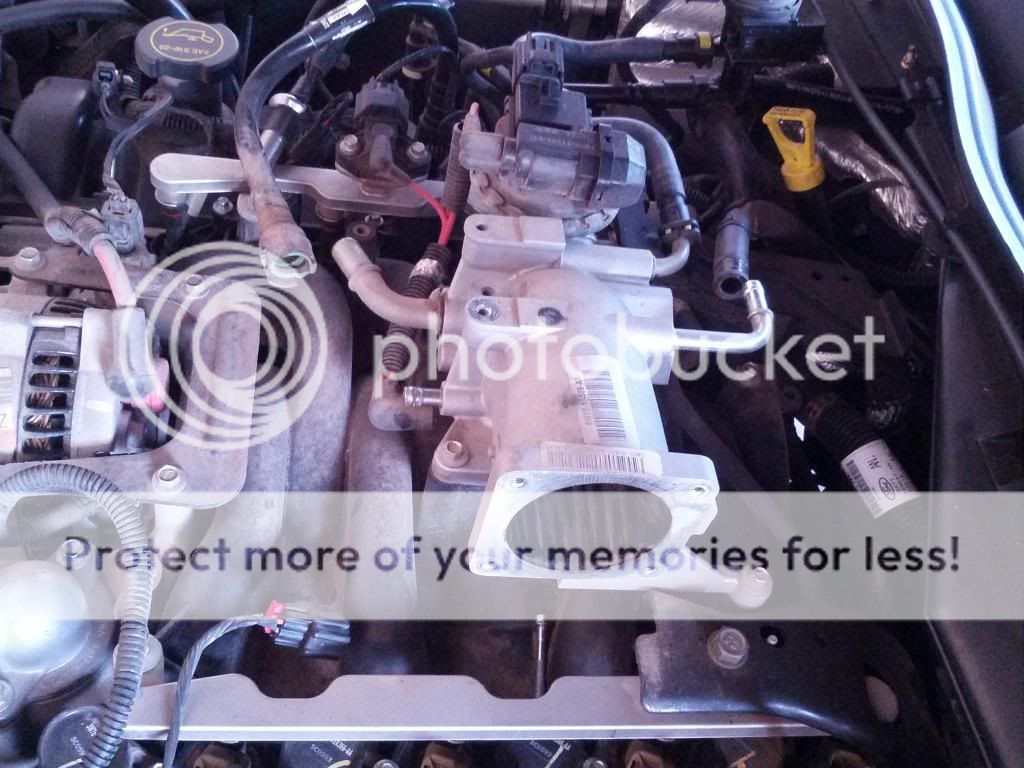

Here's how it went. I started taking hoses off and realized that I should get a before pic at least for my own reference. Just in case.
It came off to reveal one of our fine plastic intakes.
As soon as I got it off I immediately yanked the big PCV tube out. Later I'd end up changing a lot more things around.

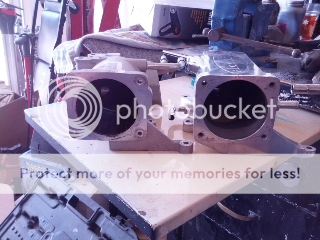

Here's looking in the mouth.
Looking in the bottom.

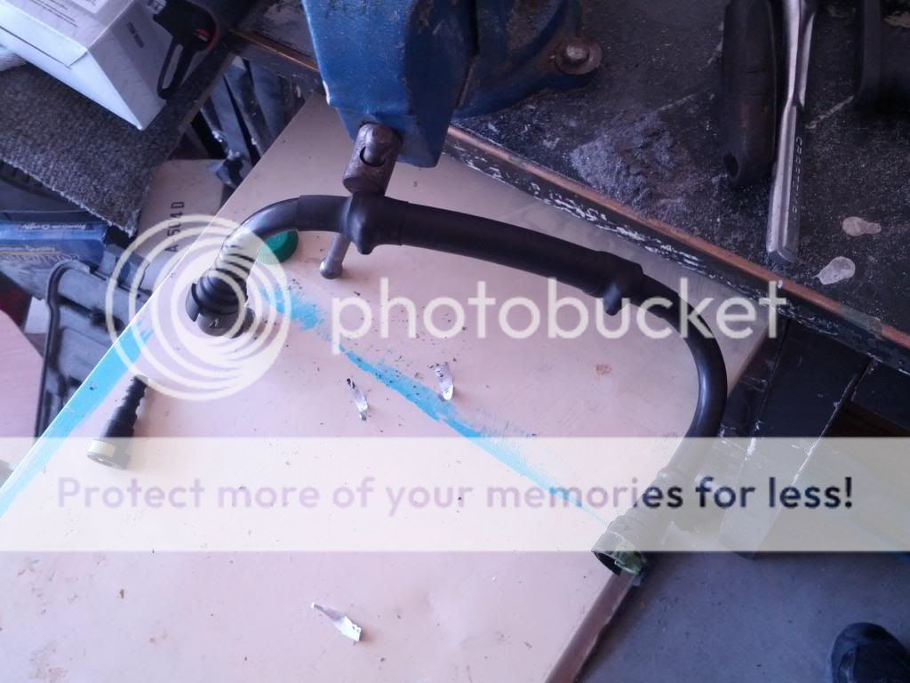

This little hose had some damage.

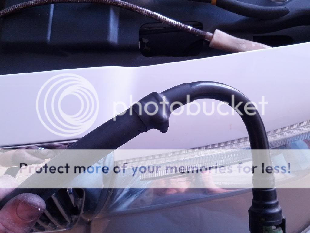

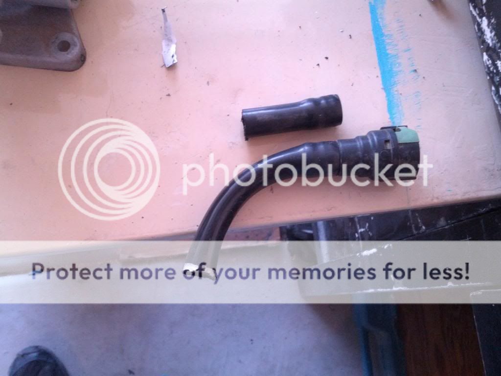

To adapt the PCV hose I used the bends and put a short length of 1/2" hose in the middle. Then I put a clamp on it and heat shrink to hide the clamps.
I cut this straight piece off and shoved the fitting back in. If you don't have a heat gun get one!
Here's the final custom shape of the tube and it fits as good as the original.

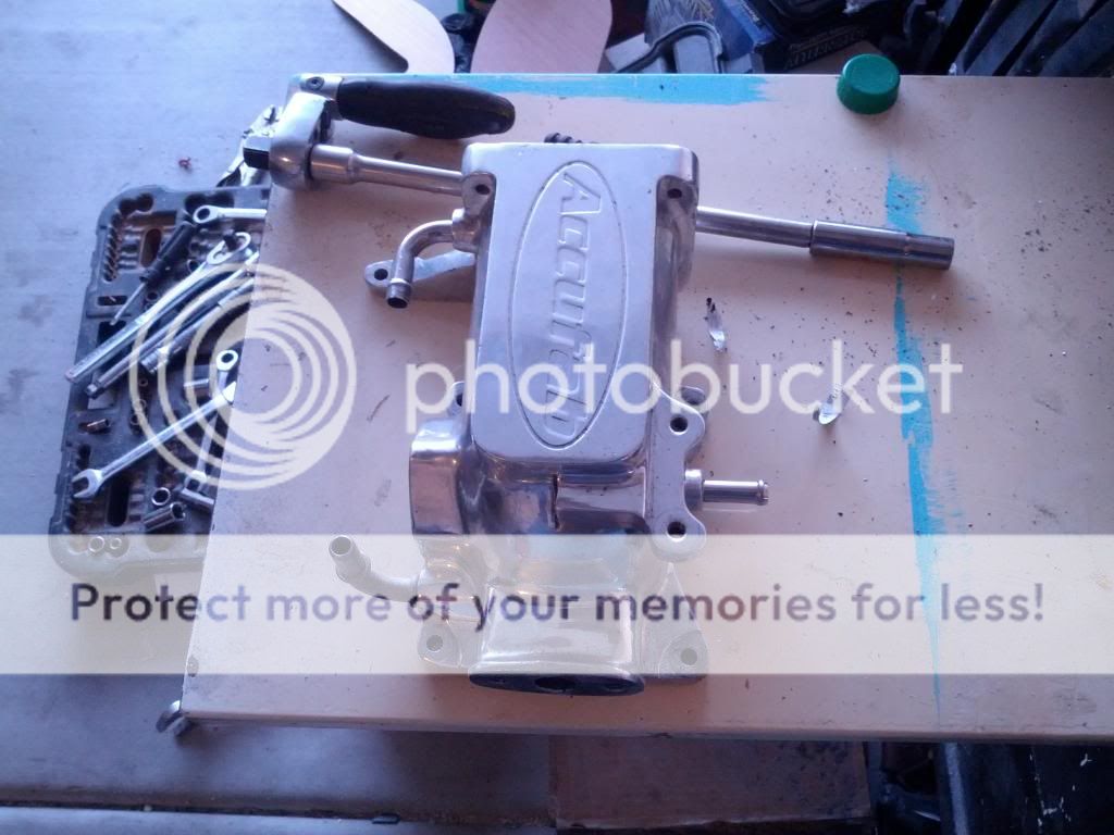

I put the Accufab on in a hurry and quickly realized that it was going to come back off. I wasn't happy with the position of the tubes. The one on the bottom left is the one that accepts the smaller snap fitting hose. I wanted to use that fitting so I pulled this out and put it in there. I pulled the elbow out the front and put a straight one in so the EGR lines could go just like they were originally. Then I liked the way the big brake booster vac line looked doubled back so I put the extra elbow that you see on the top left.
