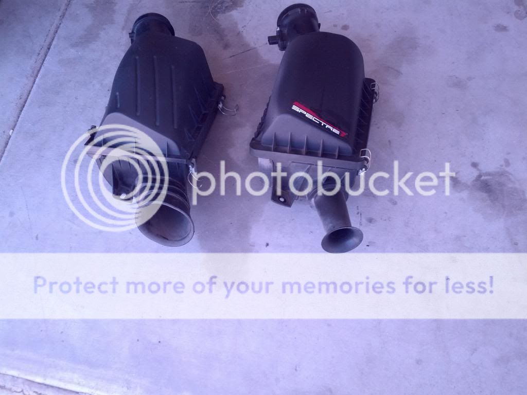

Ever since I signed up with CVN I've been looking for the optimum intake upgrade. There even was a time when I almost bought a CAI. After reading the MZT thread in the BoK I decided that a CAI just isn't necessary. The other problem that I faced was that I want more than just the MZT.
The first two years I was a member here were plagued with naysayers that said that DBW would never have TB upgrades. It might have even been said that you can't put an aftermarket plenum on a DBW 2V.
There have been a few innovators so far. BlackVic_P71 was the first poster to put an aftermarket plenum on a DBW. He made a write-up here. It looks like the DBW motor actually accepts the plenum with less mods because we can use the IAC as a vacuum port.
So, with the filter box and tube taken care of by the MZT and the plenum taken care of by BlackVic_P71's brave innovation with an aftermarket plenum the only thing left is the TB.
The TB has been a sticking point in DBW discussions because it's such a specialized part. The 2V DBW 4.6L was only offered in Panthers. It only came with a 65mm TB.
But, alas, we have options. There are at least two off the shelf options available. The 70mm BBK TB designed for use on 4.0L Mustangs will bolt right up. I think there's a 75mm that will bolt right up too.

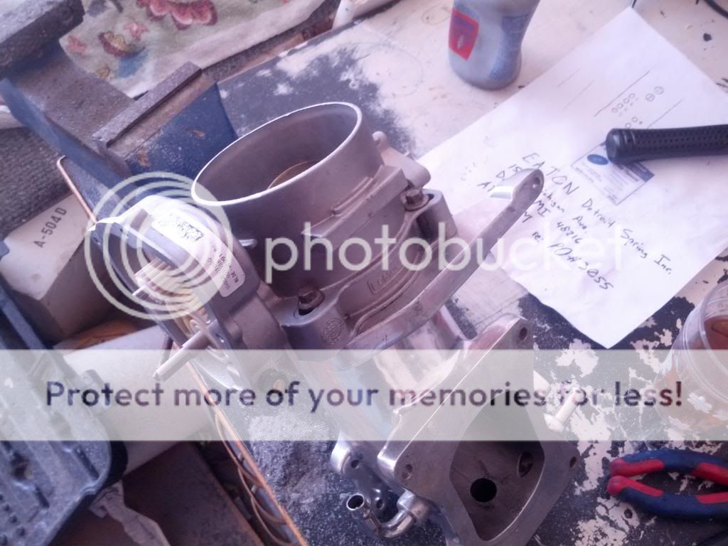

This isn't about that. I've been terribly jealous of the super cheap F150 & Econoline TB swaps. At some point or another someone posted a pic of how to modify a 3V 75mm DBW plenum from a late model F150. It's super hard to find that one obscure post so I'm not going to link it. It's out there somewhere.
Finally, I've come out with it. That's what this thread is all about putting a 75mm TB from a 3V F150 on our motors. I finally got the plenum today and I've already started messing with it. I can't wait any longer.

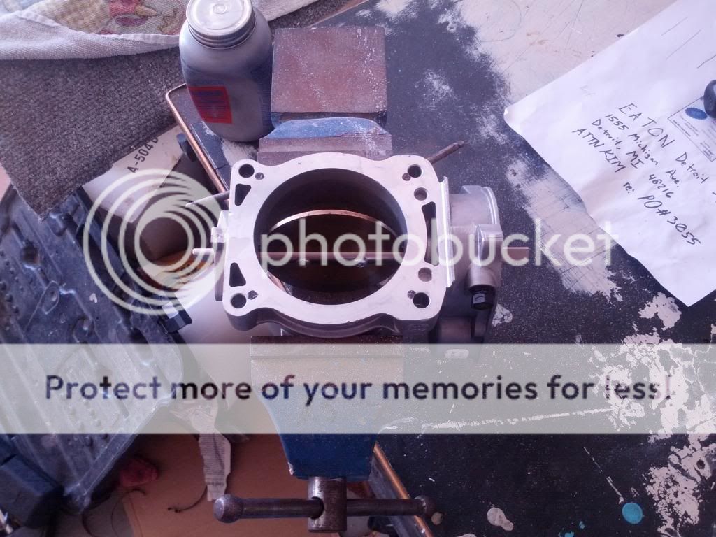

So here's the pics and how to do the modifications.

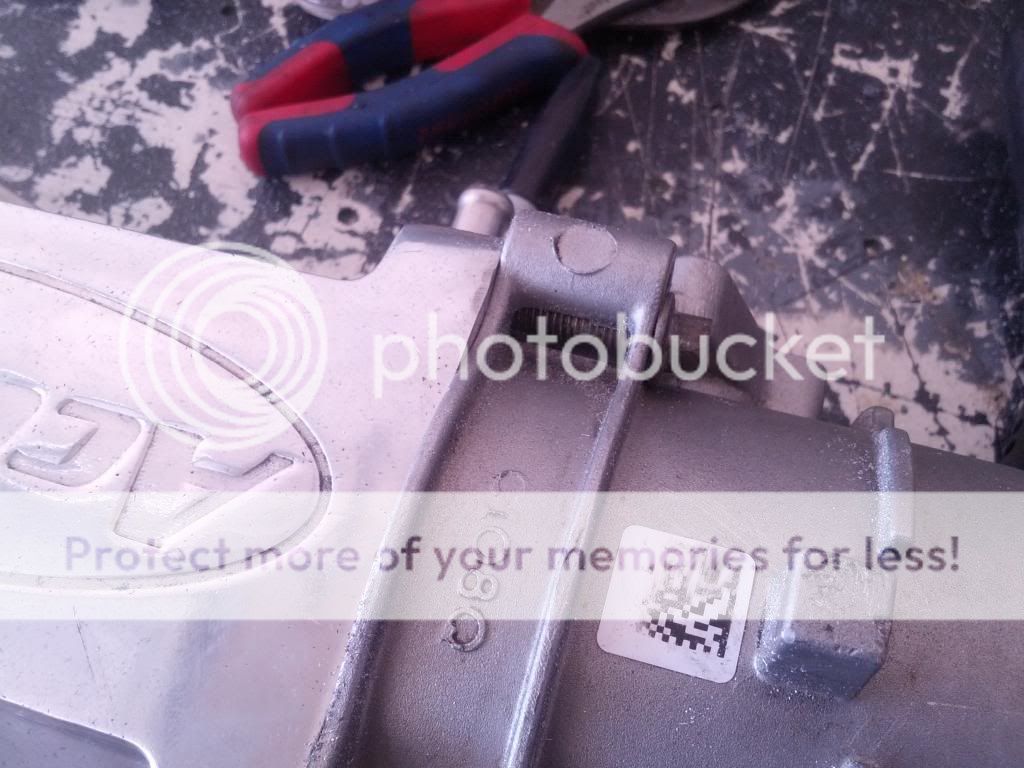

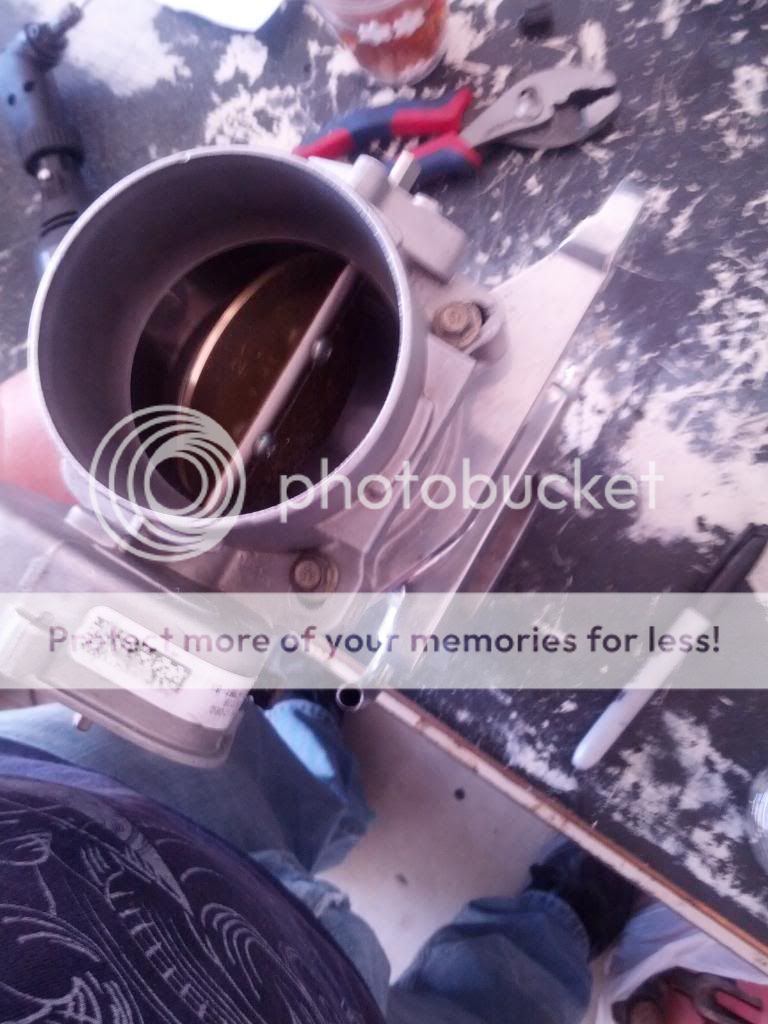

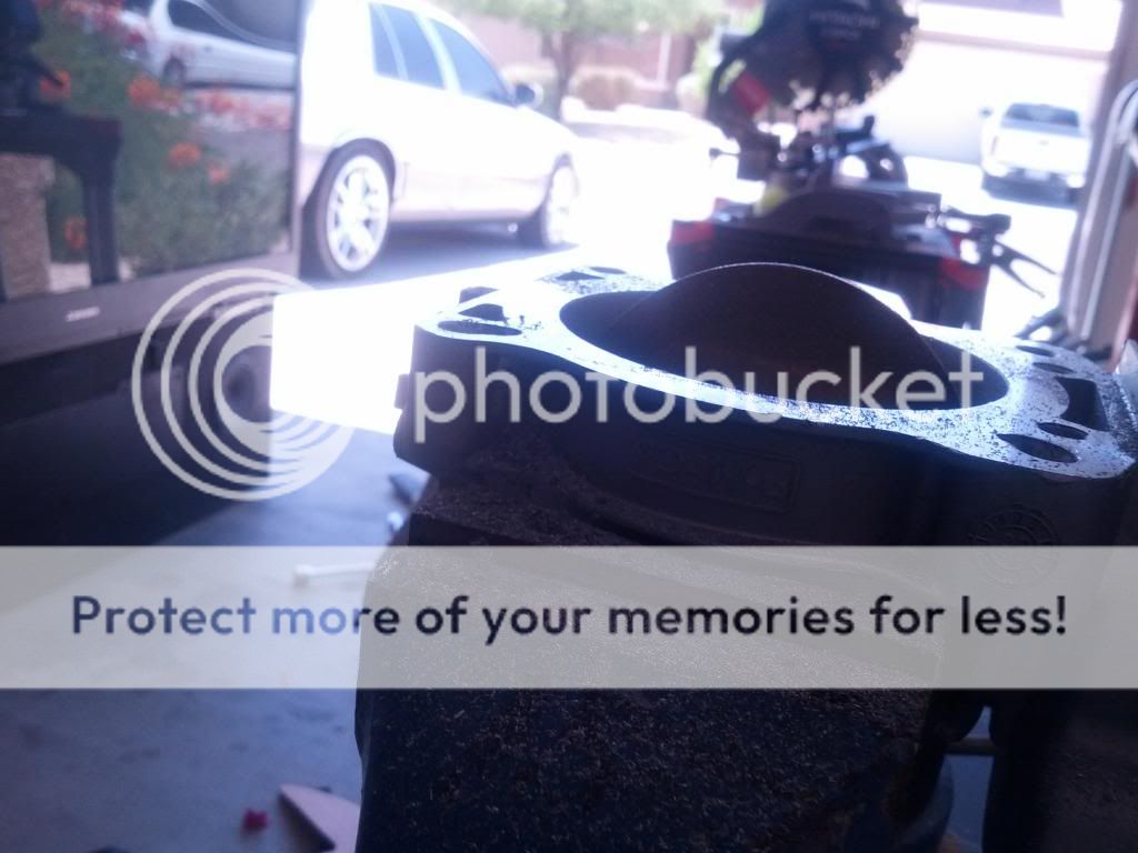

Here's the TB mocked up against the Accufab plenum to show how it fits the plenum that it was never made to fit.

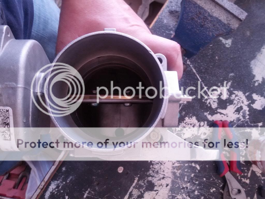

Here's looking down the barrel. You can see how the air just wants to fly into this setup. It started to suck as soon as I put them together! Note how there's no bolt holes. That's the problem.

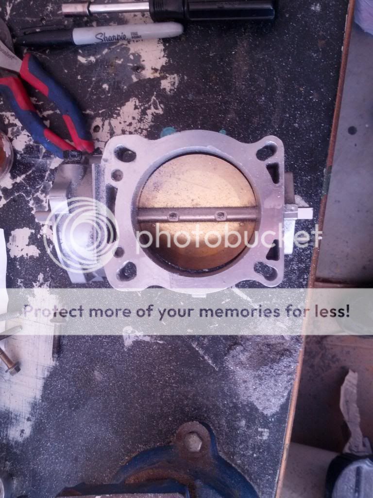

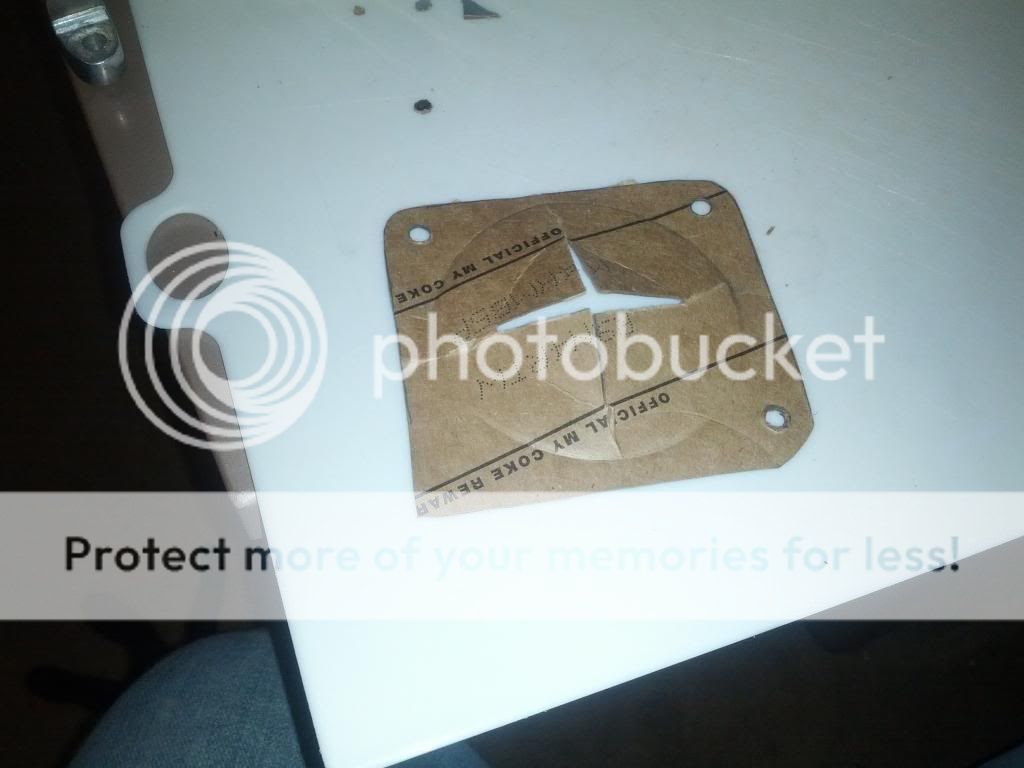

I quickly traced out a piece of cardboard to make a gasket/template. (Its a template now but I might bolt it in there later.) I traced it, cut out the bolt holes that I could get a pencil in, and bolted it on.
Then I beat it with a rubber hammer to get a super accurate outline/impression. Then took it off to cut out. It got wrinkled in a couple of places.
Having the template made allowed me to draw exactly where the bolt holes should be.
Here they are drawn on the TB with a Sharpie. My initial plan, and what the original person did, was to fill the bolt holes and re-drill them. Now I think that I will just expand them.
http://s330.photobucket.com/user/Black_S...?sort=3&o=2
This is the only spot that I'm kinda worried about. It very well looks like the bolt might come out of the TB and go back in. I'm going to try it anyway. If I have to get the holes filled later it won't matter if I made them bigger.
Tomorrow I hope to expand the holes and see if I can bolt the two together. If all goes well I should be able to put this on in the next couple of days.
It looks like I might need to consider bolts with smaller heads. Like allen bolts or whatever you call them. I might polish the TB too but I don't know if I will. If I do I'll probably cut stainless washers to hide the cut out parts.

#2717075 - 06/02/13 03:51 PM Re: DBW intake mods (straight business) [Re: Black_Sunshine]
Black_Sunshine Offline
Registered: 12/09/10
Posts: 9687

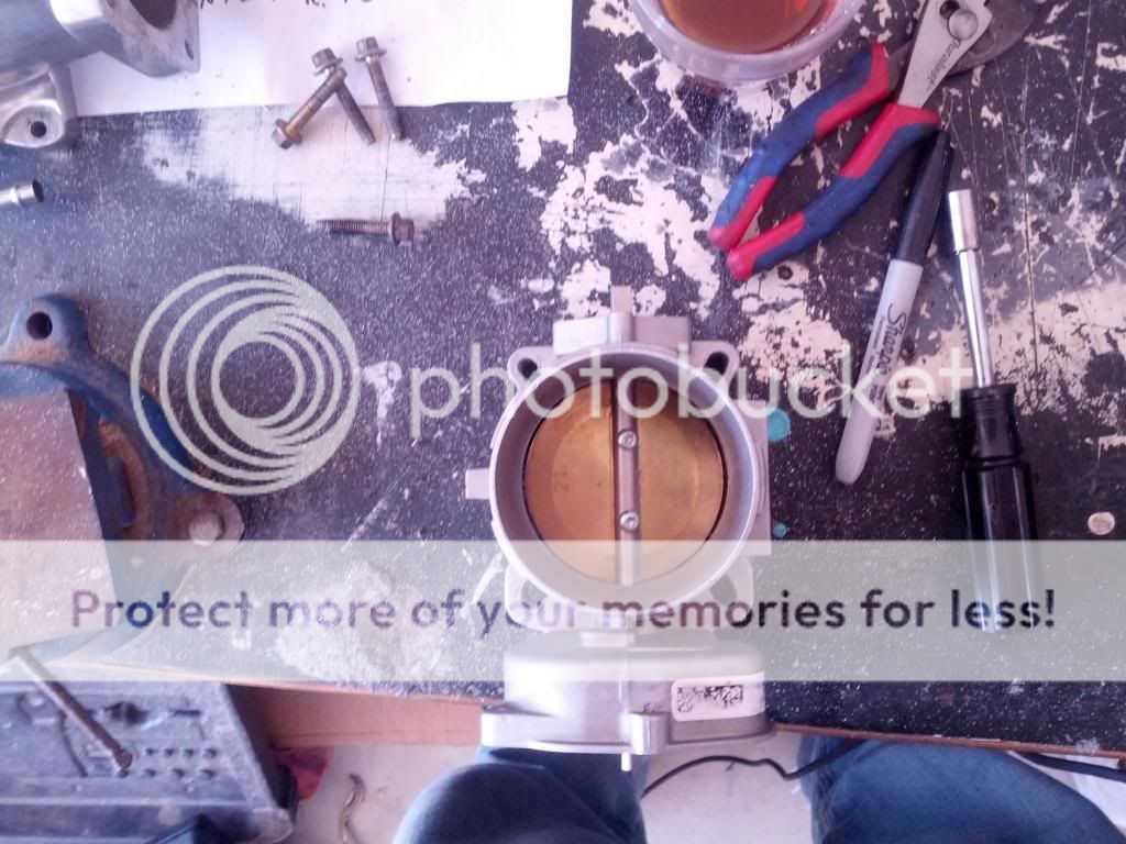

The deed is done.
Virgin on the alter?
This was by the time I got to the second hole.
As I expected from looking at it, the second hole blew out.
Although this was easy it was tedious. If the bolt won't thread in easily you better take some more away.
First bolt.
Two bolts.
Close up of one of the blow outs (there are two).
Success.
Can't see the holes well for the big hole. lol
They ain't pretty but the bolts will cover them up.
The one of the left is hella bad but the bolt slides right through.

#2717076 - 06/02/13 03:53 PM Re: DBW intake mods (straight business) [Re: Black_Sunshine]
Posts: 9687
Final pic. Now I'm debating going to O'Reilly's to get the plenum install parts (hoses and clamps).

I'm probably going to shove in this piece of cardboard that I cut out in lieu of a gasket. I don't think it will leak because the air will want to go through the 75mm hole. As you can see in the final pic the TB never closes either. I guess that it would leak when closed if it's going to.
I didn't drill any of this. I used a carbide bit in my Dremel. It's essentially a really small rotary file. Carbide goes to town on aluminum.

Good news it fits!
I just ordered my 2005-2010 F-150 TB used off Ebay. $58 shipped
Now to find a plenum, I'll probably end up porting the stock unless I can find a smoking deal on a accufab.

I stalked Ebay for almost six months and found mine for $100 shipped. I saw a few on Craigslist but they were around $200. Ebay can be an odd place. The one that I found had a short auction. When the auction popped up there were two that were bid over $150. The auction I won never had any bids and I sniped it with only seconds remaining because I was paranoid about shill bids.
75mm DBW TB

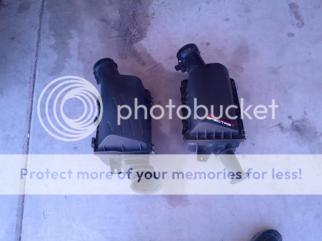

I drove to the other side of the city to get the P71 air box. Cost $65. It was hard to swallow but I don't want to wait. Didn't even come with the sensor. Made me sick. I got the 1/2" hose at Napa too.
I think total the project has come in at $250. So that's about the same as a CAI. Obviously this is better though.
80mm P71 air box.
If I had started with a cop car this whole thing would have been cheaper. I paid $95 for the air box and zip tube.

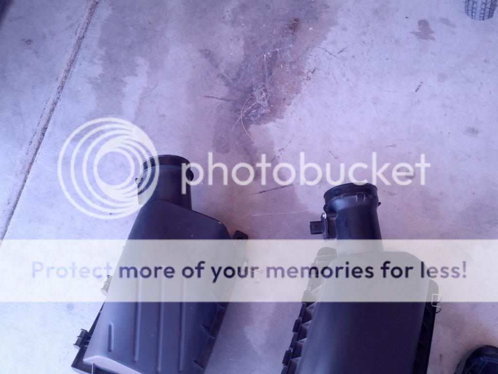

I couldn't resist. I had to get out there and put the box on. I won't get around to doing the custom install until Thursday when I'm off. I don't want to run into snags and be late for work or have to leave the car taken apart. (I work nights)
Here's the box comparison that really shows the drama. Both the snorkel end and the MAF end are smaller. The 80mm lid isn't compatible with the smaller one either. Oddly the smaller box seems to be better built.
Note that the hose clamp surface is the same. It's just necked down on the smaller box.
Trumpet versus Tuba.

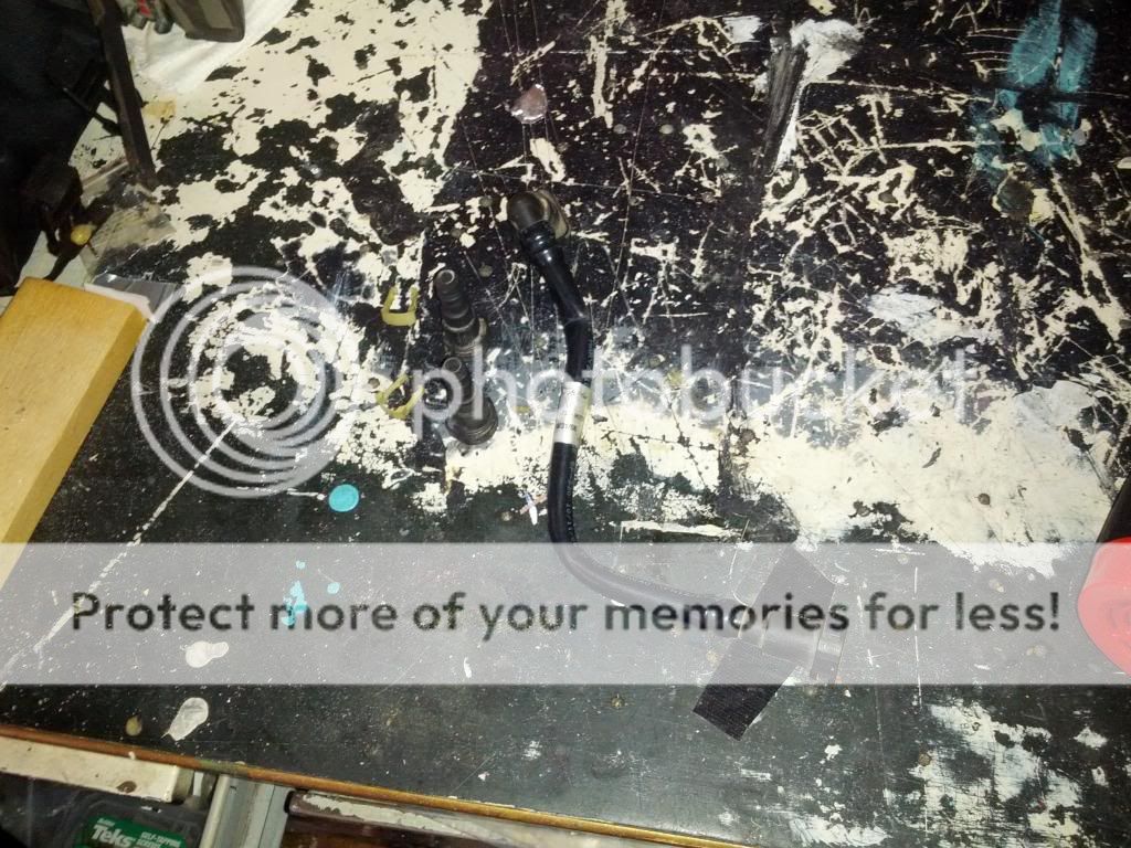

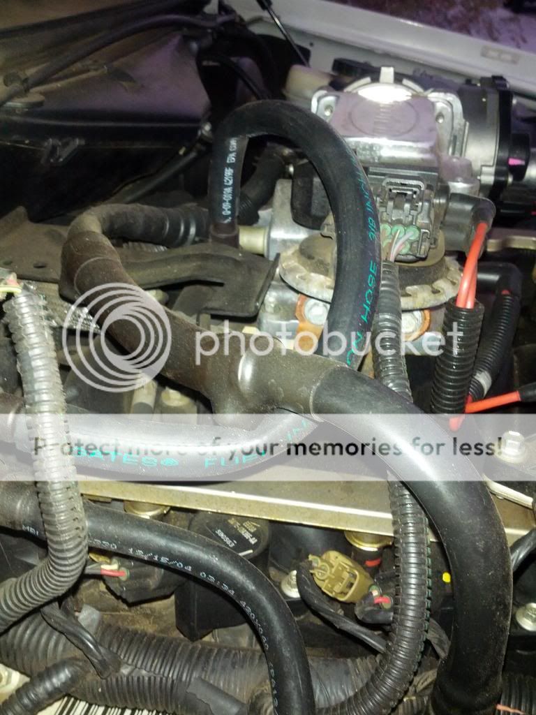

I got it all done today. Now I just need the tune so I can put the 80mm box back on and unleash the power! lol
Here's how it went. I started taking hoses off and realized that I should get a before pic at least for my own reference. Just in case.
It came off to reveal one of our fine plastic intakes.
As soon as I got it off I immediately yanked the big PCV tube out. Later I'd end up changing a lot more things around.
Here's looking in the mouth.
Looking in the bottom.
This little hose had some damage.
To adapt the PCV hose I used the bends and put a short length of 1/2" hose in the middle. Then I put a clamp on it and heat shrink to hide the clamps.
I cut this straight piece off and shoved the fitting back in. If you don't have a heat gun get one!
Here's the final custom shape of the tube and it fits as good as the original.
I put the Accufab on in a hurry and quickly realized that it was going to come back off. I wasn't happy with the position of the tubes. The one on the bottom left is the one that accepts the smaller snap fitting hose. I wanted to use that fitting so I pulled this out and put it in there. I pulled the elbow out the front and put a straight one in so the EGR lines could go just like they were originally. Then I liked the way the big brake booster vac line looked doubled back so I put the extra elbow that you see on the top left.
Edited by Black_Sunshine (06/07/13 12:30 AM)

Here's a shot from the left side looking at the brake booster vac line, the PCV line and the other (?) one.
From the front.
I'm really happy with the way the PCV came out. The other hose looks all crazy. I'm going to go to the junkyard and get another of the plastic hoses like the one under it and fab a nice custom one that will look as nice as the PCV. I think they can be bent with heat but I'm not sure I didn't need to for the PCV.
After all that was done I had to put the TB on. I had the original gasket but it would need to be port matched. I didn't feel like doing that. I just stuck my template in there instead.
And the TB on. Getting the TB on was super easy. As easy as it came off. Well not that easy. Once you have two bolts in it's that easy. The second bolt can be a little tricky because the holes are all slots. lol I had to swap my electronics and put my TPS on it. I just put them on and didn't mess with the idle screw. Everything seems fine.
Believe it or not we have come to the hardest part. The dang zip tube is too small!! lol
I tried to shove it on there. I tried to heat it up and shove it on there. I got it so hot I had to wear leather glove. It wasn't happening.
I kept thinking of the spreader tool that they use in exhaust shops. Then it came to me, I needed a conical shaped thing that I could shove it down on while heating it.
Obviously I needed to go to the kitchen to find such an object. I found a Grey Goose shaker lid. I checked and it was 75mm. Boon!!! I set the lid on the floor and started heating the tube. Then I jammed it on there and heated it some more. Then I beat it on the floor. Finally I got it all the way in there and was confident the opening was nice and uniform.
Then I got some pliers and yanked the crazy hot Grey Goose shaker lid out of the tube and immediately shoved it on the TB. I didn't know if it would shrink and I didn't want to find out.
Got that Grey Goose?
Then you wouldn't believe what I found out next! The clamp was too small!! I took two clamps and put them together. The were much too large.
I had to go to O'Reilly's and get a clamp. I still need to trim the clamp.
Once it was all done I took it to the store to get celebratory beer. It all seemed to work and no CELs. I'll keep you posted if I have problems. I'm still not running the 80mm box.

I finally got my EBAY special F-150 TB. The seller sent me the wrong one at first mad . The first one they sent was a DBW TB from a GM it looked very similar and the guy said his wife shipped the wrong one. I then looked back at the ebay ad and he advertised a F-150 TB, but had the picture of the GM TB in it.
Once I got the correct TB I compared the ford to the GM, the interesting thing is the bolt pattern for the GM TB appears the same as the ford and the TB size is close at about 72 mm. There was only one electrical connector on the GM but it had 6 pins (motor on same side as the TPS). The ford has two connectors and 6 pins total (Motor on opposite side as the TPS). I am sure someone could mod a harness to work on the GM if they had the GM plug end.
It could possibly work on a Vic, but there is a chance the impedance on the TPS would be way off and it would not work correctly with the ford EEC as the computer would think it had another throttle angle. If the TPS from the ford could just be retrofitted on the GM TB, then we would have another DBW TB option that could work. I have to ship the GM TB back or I would open it up.

I would be more worried about the motor in it working correctly than the TPS. Either way it sounds like too much trouble.
I've run a whole tank of gas through my car since I put the 75mm TB on it. The economy seemed the same but I'm not 100% sure on that yet. I'm going to try to take it easy on this next tank and see what happens.

That is good news, the fuel economy should be the same if have been driving the same. That means the new TB is measuring and metering the flow equivalent to what it was before. The only difference should be at WOT, you can now let in a little more air, which allows more fuel to be metered in, and you can make more power.
If your gas mileage went in the toilet, we might have a problem using the F-150. That would mean it is not sending the correct throttle position to the computer as the F-150 TPS is calibrated differently. I would think the closed loop EEC system and O2 sensors would keep the car from going way too lean or way too rich but if it was off just a bit at cruising speed the mileage would suffer.
I agree a GM TB would be too much trouble, since we now have a ford factory part option that works. If you had a free GM TB and an extra ford TPS it might be worth trying if you wanted to save $100.

Ultimately I'm sure that the TPS is off because 10% open with a 65mm TB is not the same as 10% open with a 75mm TB. Maybe the MAF is making up the difference or something.
It's noticeable that more air goes in with less throttle. WOT actually feels closer to the same than the lesser throttle positions.
I'm going to start reading about tuning and I'm sure that I'll learn a lot more about it then. I can't wait until I can reprogram it and put the better air box on. I've gotten a taste of what's to come and it's driving me crazy.

It appears that the computer may be self calibrating for the new TB as long as the voltage out of the TPS is linear throughout its range, see link below. The computer is only reading the difference between WOT and idle by voltage to figure out the instantaneous throttle angle. The MAF is what really measures the air for the computer to meter the fuel so that is why a tune is required for the bigger MAF. The throttle angle does not play into how much fuel is needed during steady cruise, only when the motor is at idle (0% open) , rapid changes in throttle angle, (acceleration or deceleration) or full throttle (100% open).
The TPS serves as the input for the computer to set the timing curves, fuel enrichment based on driver input. The TPS probably affects the shifting of the tranny, as well and some other emission crap, like turning off the EGR at WOT.
So what I think is 10% throttle on the stock TB is the same as 10% throttle on the F-150 since the computer only cares about what % of open throttle plate you are at (what you are doing). The timing and fuel curves are selected from that information, but the amount of air is caught by the MAF. We now can get more air in less throttle angle at cruise, so we have a slightly less throttle angle at the same engine speed (maybe 8% now instead of 10%) but we are still in cruise mode and the computer should still think we are in cruise mode. That should not effect the timing or enrichment system hopefully. The computer should still know when we are at WOT, idle, rapid acceleration, or deceleration even though the throttle angle while cruising is a little different now.
Here is some good material on Ford EFI on this site for reference, mostly EEC-IV stuff but probably is still valid. http://oldfuelinjection.com/?p=30
I hope someone more knowledgeable on Vic EECs chimes in here.

I just followed the Accufab DBW write up and this excellent write up and installed the Trick Flow plenum on my '06 with the F-150 DBW TB.
The only things I did differently were:
I followed the Accufab DBW install except:
1. I tapped the IAC port to 3/8" pipe thread and installed the brake booster nipple at this port. This kept it away from the EGR tube, and over the top of the steel bracket. I used the lower port that was for the brake booster and put in a 3/8" iron pipe street el 90 bend pointed up followed by another street el 90 bend pointed toward the valve cover and added a 3" section of 3/8" pipe to attach the 5/8" new PVC hose. This raised the PVC tube alignment above the steel bracket and pointed right toward the valve cover. I cut the existing PVC tube at mid point and attached a 5/8" hose from the iron pipe nipple to the existing hose in a straight shot, no bends.
2. I hooked the 3/8" hose on that sensor on the firewall to the port closest to the TB on the firewall side. I used a couple brass pex 90 bends to keep any loops or bends out. These 1/2" pex 90 double nipples work really well with the 3/8" fuel hose and do not need clamps. They were only $1.80 each at Lowe's.
3. I used the F-150 TB motor but the crown vic TPS.
Suggestions:
1. I bought a TB gasket for autozone to use as a template to scribe the F-150 TB for drilling. I then used it on the install. I ordered the F-150 but Autozone gave me one that fit the crown vic TB frown , so I had to enlarge the bore a little but the bolt pattern was correct. That ended up being easier than moving the bolt holes in the gasket and gave me more gasket material around the bore to prevent leaks.
2. Check that bores are aligned when you start bolting the TB to the plenum through the slotted holes one at a time. When you add one bolt that throws off the bore alignment, you know that is the one that needs more adjustment. I had all four bolts in and looked at the bore and it was off by 1mm. I then proceeded to hog all four holes a little to the side, when it was only 1 that was off.
3. Use the white paste pipe dope on all black iron and brass nipple connections. It doesn't harden, acts as an anti seize, and prevents vacuum leaks.
4. Hit the EGR bolts on both sides with a little PB blaster.
5. I had to grind the head of one bolt a little that was hitting the TB outside body. I had to grind the bottom bracket on the Trick Flow that was hitting the steel bracket on the manifold.
Mistakes I made written down so you don't make them:
1. Be careful wrestling the Zip tube over the 75mm TB, I busted my PVC nipple half way off the zip tube and had to glue it back together. Follow this install guide and preheat the zip tube with a heat gun and hammer a tapered object in to stretch it. Have a 4" clamp ready, your old clamp won't fit, because once you shoe horn this size 12 foot into a size 8' shoe it wants to pop right back off with hardly any pressure. I used the clamp on the other end of the zip tube, and bought another 4" one at Lowe's on my test ride. I used the original TB clamp on the zip tube to grab the PVC port I messed up and keep it clamped to the zip tube while the glue dries. I'll leave it there.
2. Swap out the TPS on the TB first before installing to the plenum and bolting the plenum on. I tried running it with the F-150 TPS and it definitely is off, and idled too high. Throttle response was really bad ass though took about 1 sec to hit 3,000 rpm+. Swapping out the TPS to my Crown Vic one I broke one of the screws off mad .
Test Drive:
The car runs really well, it took a minute or two to find its idle, but it is not throwing any codes, missing, or pinging. The throttle response off idle is right now and I found myself needing to be much more sensitive with the pedal. Haven't flogged it hard yet, but did floor it coming up a steep hill. There is definitely more top end pull above 3000 rpms. I can't tell what I lost down low if any. I need to get my J mod in to get rid of the slushy mamby pamby stock shifting that is robbing all my low end torque to see if I lost any with this mod.

No, I did not reset the computer. It seems like the computer had to learn the new TB and adjusted itself. If I have drive-ability problems or poor gas mileage I will try that.
Here are some photos:
Final Hose Routing, notice the hoses are all over the EGR pipe heat shield. Putting the booster hose on the lower port on the plenum would have routed it next to the EGR tube and under the bracket. I didn't want these touching.
http://s1366.photobucket.com/user/Caddylackn/media/May2013093_zps95f3abb7.jpg.html
Moving the Brake Booster Port to the IAC and moving the PCV port up over the heat shield.
Finished picture, I should have painted the plenum satin black or cast aluminum.
Edited by BlackVic_P71 (06/23/13 05:40 PM)

Finally, officially finished this project today.
Wednesday when I left work I had a little problem. A vacuum problem. She was really sucking wind. I took a look and I think the PCV was loose from the back of my Accufab. I need to use some RTV to glue it in or something.
It reminded me that I still need to fix the evap line. When I installed the Accufab I just used a piece of injector line to replace the nice pre-bent evap line.
My plan was to use the plastic tube from the evap return to make a a custom line for the vacuum side of the evap.
If your vacuum side on your evap is rotted out you could make a new one this way too. It'll last longer than the original too.
Here's the salvaged return tube and some fresh salvaged connectors.
The kinked up, offending hose, that my friend so eloquently said looks like 'death'.
I cut the plastic tube into two good pieces to use for the bends. I needed a way to bend it with out collapsing it. I came up with a mandrel bending system. I shoved piece of coaxial cable in it. Then hit it with a heat gun. Then I bent it and waited for it to cool. It didn't bend as pretty as I hoped it would but I know that it's open because the wire held it open.
I thought that I would put clamps on the hose but it was hard as hell to shove in there. Even with WD40 and the heat gun. I got it in there about 1/2". Then I wanted to make the bends look less like death. So I covered the connections with heat shrink.
Here's the finished product.
The installed product photo came out terrible so I'll get another tomorrow.
