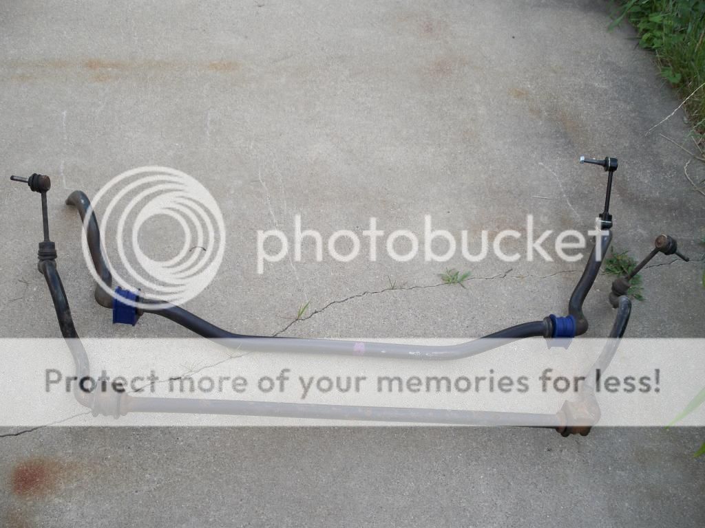

First off, the '00 P71 29.5mm bar next to the stock '95-'97 26mm bar:
Note the extra bend in the middle to clear the oil cooler on P71s, civi sway bars don't have that bend.

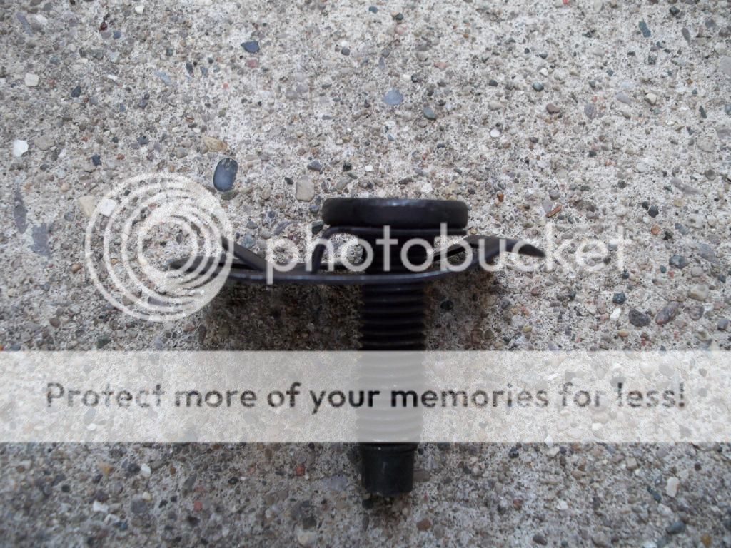

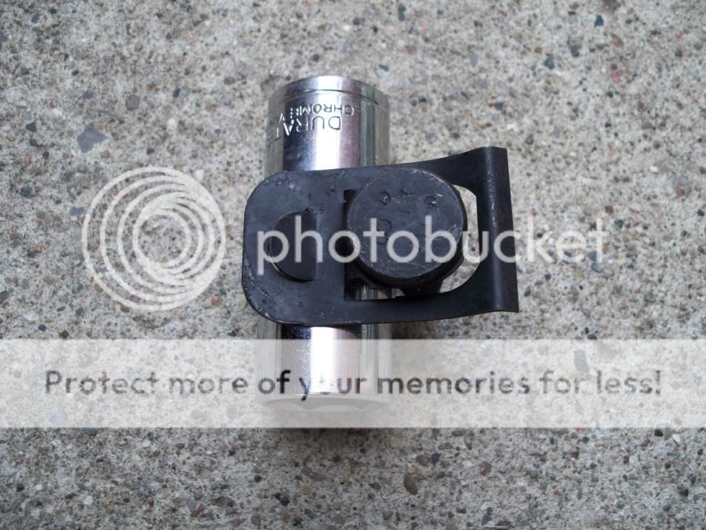

Next, here is the stupid clips/studs:

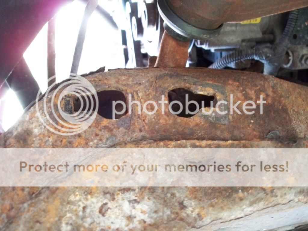

And the pic that I REALLY wish I had when trying to get the stupid clips out of the frame:
As you can see, the clips slot into a keyhole shaped slot in the frame, there is a tab on the clip that keeps it from sliding back out of the slot. With some prying I was able to release the tab and then knock the stud/clip out of the slot after removing/cutting 1 of the studs on each side.

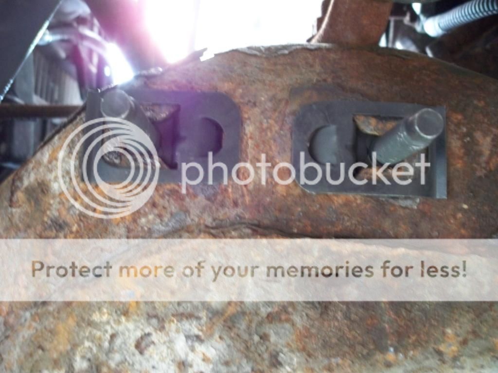

Here is the studs installed in the frame:
