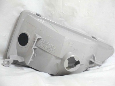

#2650497 - 01/06/13 11:06 AM Re: Ford focus fog light install...with pics [Re: BigNSlow]
JayJohnPaul Offline
Registered: 08/20/10
Posts: 39
Loc: Kuwait
Originally Posted By: BigNSlow
They look the same so I don't see why not.
IDK, they look a bit different from the back.
European Spec:
American Spec:
Do you think, they'll fit?
Thanks!

#2650504 - 01/06/13 11:24 AM Re: Ford focus fog light install...with pics [Re: CrownVicBoyz]
Bulldog5_oh Offline
Registered: 06/17/10
Posts: 2930
Loc: Hollywood, Maryland... USA
You should have plenty of room for them to fit no matter how different they are in back. You just have to make your brackets to fit accordingly
