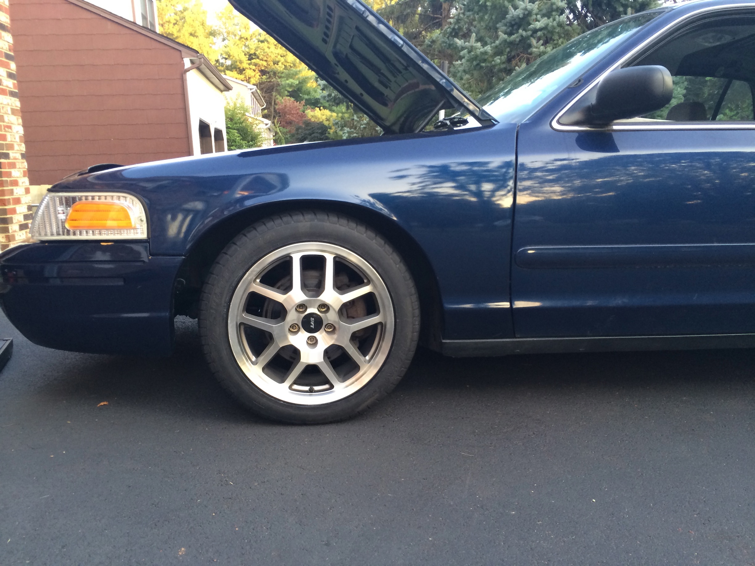

New wheels and tires!!
She's also lowered, and i'll have to get some good pictures of the car the way she sits right now. I got a set of eaton detroit -1.5" front lowering springs which luckily turned out just fine, and a set of custom made rear coil springs -1.0" from coilsprings.com as per [email protected]'s suggestion. Front struts are KYB's and the rear shocks right now are new cvpi ones.
2009 mustang gt500 wheels (all four are 18x9.5") and I got a new set of tires up front which are some sumitomo 255/45/18's. Still waiting on the rear tires to come in, I ordered me up some sumitomo 275/40/18's for now, I guess i'll have to get a set of drag radials also. ;-)

#2763468 - 10/02/13 11:45 AM Re: THE CobraCrownVic is ALIVE!! [Re: Ari]
Posts: 14597
Looks great!

#2763487 - 10/02/13 12:39 PM Re: THE CobraCrownVic is ALIVE!! [Re: Ari]
STLVIC Offline
Registered: 10/28/12
Posts: 706
Loc: Minnesota
Moar pichers!

#2763501 - 10/02/13 01:28 PM Re: THE CobraCrownVic is ALIVE!! [Re: Ari]
freewayfuntime Offline
Registered: 03/24/09
Posts: 513
Loc: Oakland, CA
Only 1 pick? What a tease lol. Look good.

Haven't had any time at all lately to get any pictures, i've just been working my ass off.
