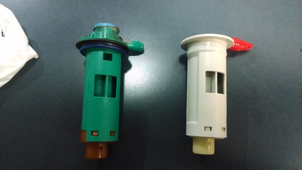

the tank came out rather smoothly. Nothing broken,few headaches. Had go cut the wires connecting to the pump as the plug was wedged under the brake line and was unreachable, but a simple snip and splice fixed it. However, that is when I discovered the difference between 2005 and 2006 tanks
The large fuel vapor recover valve changes from a twist and lock to a push in. So the twist and lock won't work in the new tank. I'm ordering the newer part from Ford and hoping it comes with the gaskef for the push in, but it's doubtful. I cannot find a part number for the push in type gasket. This is probably going to become a make it fit problem, but I'm hoping the new part has what is needed. Updates when it comes in

Make it fit solution: cut the old hole out, weld to the new tank. Have to cut the hole bigger on new tank. Even if you have to buy a welder to do this it's better than paying $500 for the Ford tank. Obviously it would be ideal to have a donor tank to get the 06 grommet. But I'm impatient and a bit unlucky so there it is.

Loc: Wisconsin
Here are the difference in valve. Old is green, new is tan
Literally everything else is interchangeable. This part set me back a week waiting for the new part (that didn't come with the grommet, nor could I order the grommet from my local Ford dealers or auto parts store)
