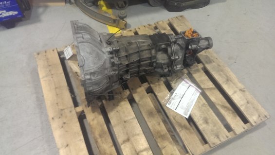

I've been talking about doing a 6 speed swap for ages now, pestering quite a few people with questions, etc. Finally going ahead with it.
A few weeks ago I picked up this on corral.net:
After seeing some of the difficult people were running into with the t56 magnum, and the cost, I figured I'd probably be ahead to go with a regular t56. It's already got the 26 spline input shaft upgrade, and it's currently at Libertys Gears in Taylor, MI getting rebuilt with new synchros/bearings and a few other minor upgrades.

I think you made the right decision with the T56 instead of the Magnum. In hindsight, I should have done what you are doing. It would have saved me some aggravation and a good amount of time.

Your experience was, I think, the tipping point for me actually, although I'd been reading about a ton of other little issues people were having.
