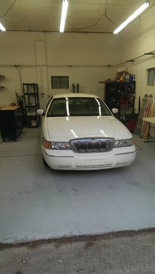

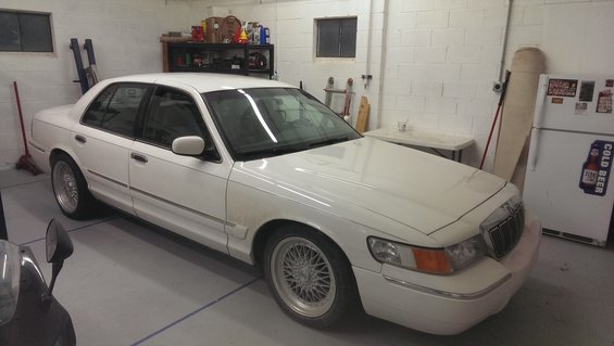

Update time.
Wednesday I spent getting the car moved to it's temporary new home where I'm working on it.
Prior to that on wednesday, I installed these, although the rears need to be tucked in a bit more:

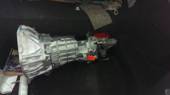

Also on wednesday, I picked up the transmission from liberty:
I'm thinking rather than use a silver/aluminum colored paint, i'll probably just hit it up with a high temp clearcoat. I'm glad I asked them to glassbead the case, it looks awesome.
The trans already had a 26 spline input shaft. In addition to that liberty did the following: replaced 2nd gear, which had some chipped teeth, brand new 1-2 and 3-4 synchro assemblies, new blocker rings for all synchros, new bearings, bronze shift fork pads, billet shift keys, and they shot peened and polished some of the internals for smoother shifting. Can't wait to see how it drives.
Today, I finished moving my tools and the rest of the parts I have out to the garage I'm working out of, got my to-do list taped up on the wall, and drained the trans fluid. The fluid was surprisingly clean given the trans has ~180k on it, and the fluid has 45k or so. Also drained out the torque converter and started removing the wiper cowl.
More coming tomorrow.
Member of the 4.6 Mafia

#2840567 - 06/07/14 04:03 PM Re: All the cool kids are doing it.... [Re: Captain_Slow]
Captain_Slow Offline
Registered: 12/21/08
Posts: 1312
Loc: The People's Republic Of Ann A...
Thanks guys. The wheels are Esm-002r's. Similar design to our hpp rims.
Question for people with sw catbacks... Is it normal to need to disconnect the exhaust to remove the driveshaft?
