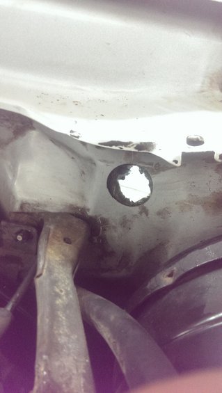

So, a few things (pictures will follow soonish).
I actually managed to get the factory brake pedal switch to install with these pedals, albiet rotated somewhat differently than stock. I know this wasn't supposed to be possible on older versions of pier's pedals, not sure if I got lucky or a design change there.
There are a few things I noticed though. One end of the clutch quadrant that doesn't have any spacers/etc on it seems to have a bit of side to side play in it, is this normal or am I missing a piece that should go in there?
Also, as far as the hole for the firewall adjuster goes, I'm a bit nervous. From what I've read it seems that the way to go about doing it is take a pen/whatever and rest it on the top/part of the quadrant where the cable hooks and see where it hits the firewall, and start the hole there, correct?
From that point, drill the hole out larger and then use a dremel to expand it out to the size of the firewall adjuster, and then make a plate/spacer/thingy to hold it at the proper angle relative to the quadrant. Somewhere in here I'll probably want to take the brake booster out of the way for clearance.
Am I missing anything/any feedback on this step would be appreciated.

The play side to side will give you some room for adjustment with the cable.Once you are perfectly set and the right tension is on the cable it wount moove but you can always use washers if you really want to be exactly st the way you want but I never did.
you pretty much got it

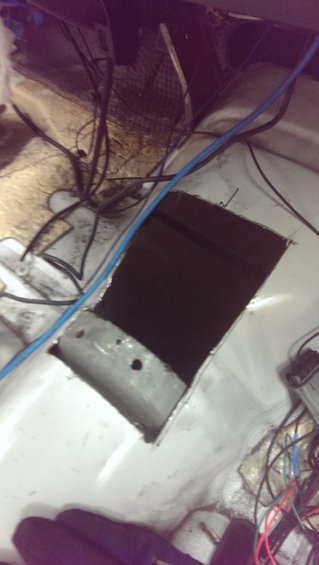

Update time.
Wednesday I spent getting the car moved to it's temporary new home where I'm working on it.
Prior to that on wednesday, I installed these, although the rears need to be tucked in a bit more:

Well, I'm pretty sure I've hit the point of no return now. Did this last night smile
Today I should be doing the hole for the firewall adjuster.

So, while I missed STAP this weekend frown I did get some good progress made.
After drilling the pilot hole for the firewall adjuster I went out and picked up this:
Which I used to drill this:
The stepped drill bit was perfect for the firewall hole, just a tad bigger than the steeda adjuster in diameter, and makes cutting a hole in the sheet metal (with an uneven surface) really easy. Also, the hole seems to be pretty well lined up with the clutch quadrant, so that's definitely good news.
