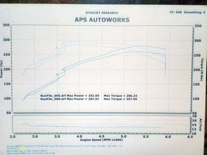

If you want Dyno proof I can post my 1st run with stock 65mm tb and stock ported plenum vs. my 2nd run with a 75mm tb and ported 75mm plenum. I gained torque and horsepower across the board

Shows both runs. With 65mm tb/plenum vs. 75mm tb/plenum. second run was also with addition of underdrives. The underdrives account 7hp.

Nice graph 09mnsp... Good to see factual evidence posted on here.
