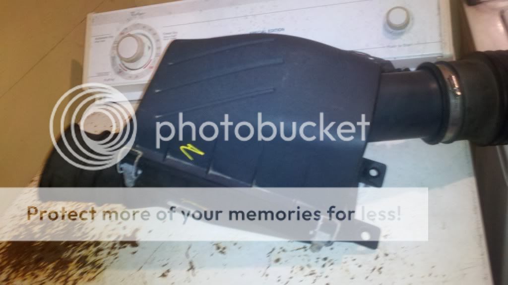

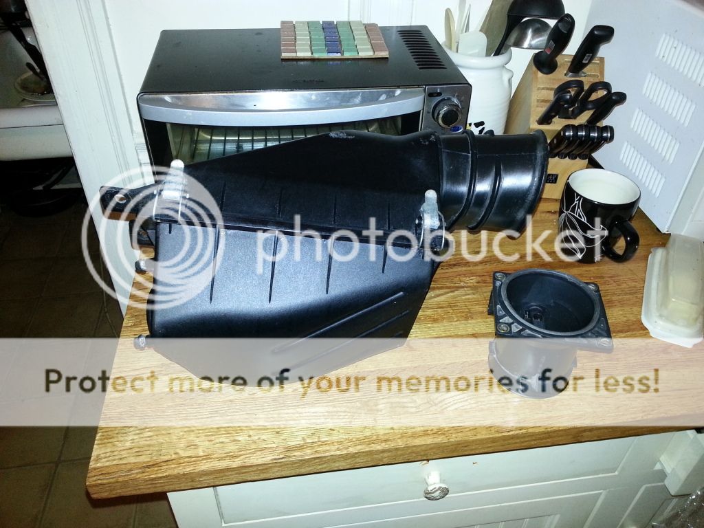

The only difference between the 04-2011 P-71 airbox and the 03-04 marauder is the MAF. The Marauder is a bolt on type similar to a 03-04 70mm type with the integral IAT sensor but it's 80mm. the 92-2002 MAF pigtail fits this sensor but the older ones don't have the IAT wires in the pigtail, so you have to mount the IAT or swap in a 03-04 6 wire pigtail.
The 04-11 MAF has the integral housing/lid and the "Blade" type sensor which uses the 05-11 pigtail connector.
The 04-11 Blade MAF supports lower airflow volumes compared to the MM this is in the supercharged range and many supercharged MM owners upgrade to a 90 MM MAF anyways. For a 2V consider this a non issue.
The 03-04 MM boxes are discontinued and go for $100 - $150. the 04-11 P-71 can be harvested from the junkyard cheap, or are still available new.
