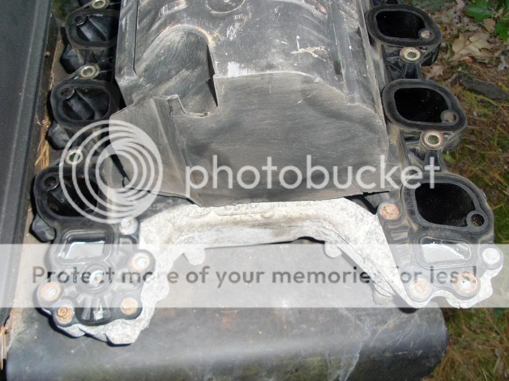

Most of the time, you can fix the leak on the updated type Ford intake You can see on this picture the aluminum crossover corrodes and causes leaks against the plastic intake, note the white line between the plastic and aluminum
Read here
https://www.crownvic.net/ubbthreads/ubbthreads.php?ubb=showflat&Number=2488212

heres some better shot of the problems on this intake.

That's what I think mine is doing. What do I need to fix the one I have? A gasket set? Thank you for mentioning that!

A new intake. Once the plastic supporting the seals gives up like in Pier's pictures, the intake is as good as dead. I had a Dorman fail in the same way on my Townie last summer.
