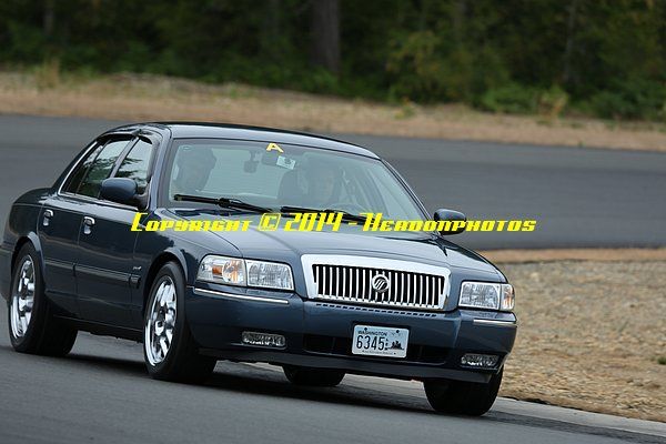

Addco front and rear bars, KYB "Police" shocks and struts. Stock springs.

man, I need to find a set of GT500 wheels. They look so good on these cars.
Thanks for that pic, how's it ride on the street? Looks like it handles well on the track, though I don't know I'll be going quite so far with the mods as you've gone. I'm pretty sure you've got 2-3 times the value of my car just in mods haha.

Street ride is nice. Most that ride in it complement it.. It's noticeably firmer than stock, but doesn't pound your brains out and the rough spots. It's more comfortable than a stock P71, but out handles it.
