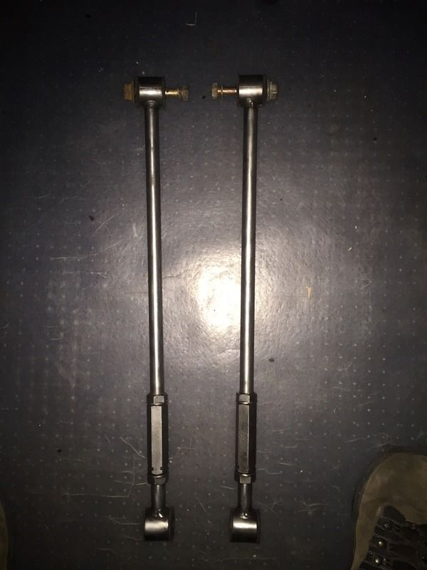

I am looking for a HD bell crank for the watts link. Does anyone make such an animal? I find complete watts links, or just the arms, but no bell crank. I am going to try these, so I can adjust it. My only reservation is its straight, and I can not find any thing on why it is curved, other than clearance.

#3328593 - 08/22/16 06:59 PM Re: Best replacement watts link? [Re: MasterofNone08]
Posts: 18493
If you mean the arm bolted to the pumpkin, thats a rather robust cast iron piece. If you don't worry about pitman arms on pre-rack 'n pinion cars, then you got nothing to worry about. =-)

#3328633 - 08/22/16 07:47 PM Re: Best replacement watts link? [Re: MasterofNone08]
EZlivin11 Offline
Registered: 03/18/16
Posts: 1132
Loc: Central Coast Of CA USA
Here is hat I'm seeing
1st the watts arms are stamped flex-steel made for comfort not performance
2nd The CVPI is now lowered a bit, so the bell-crank is not centered anymore
3rd A lesson that You should never to forget, when you stiffen a chassis or suspension, the force from that area WILL be transmitted somewhere else... If you do not complete the processes form beginning to end of the path that that force travels, You will be chasing it till you do stiffen it start to finish. EX. If you firm up the front the force will move to the rear, so If you jump to the rear and firm up there, it will head back to the front to a point where it is or becomes lose so you firm it up there and back it goes and so on... That having been said the watts link is the last section in the rear suspension, and with the stamped arms I can feel the wrap up in a corner when those arms flex under pressure. I have the ARB bolt with oversized tubular arms, leaving the bell-crank bearing being the weak link left for the force to travel to, so it should be looked at for possible upgrade, or keep a spare on hand...

#3329041 - 08/23/16 07:04 AM Re: Best replacement watts link? [Re: MasterofNone08]
chipdog4 Offline
Registered: 02/04/03
Posts: 3089
Loc: SouthWest Indiana
Can't tell what diameter rod that is, but I'm sure it will still bend or break before the bell crank does.

#3329633 - 08/23/16 04:07 PM Re: Best replacement watts link? [Re: MasterofNone08]
EZlivin11 Offline
Posts: 1132
You have a point the strut rod is 3/4 od x 1/2 id.. it is a camber adjusting rod for a 90's Pontiac Grand prix, and I used it on a 95 SHO for rear control arms. Recycled engineering or as the American Pickers call it Repurposing. It will become a watts link, both arms are connected up, so after lunch I am going to begin measuring compression, drop, along with every moving plane in the rear suspension and insure there is not any binding.

#3330985 - 08/24/16 05:04 PM Re: Best replacement watts link? [Re: EZlivin11]
Merc1973 Offline
Registered: 06/12/15
Posts: 332
Loc: MI
Nice, Are those a one off custom or available for purchase?
